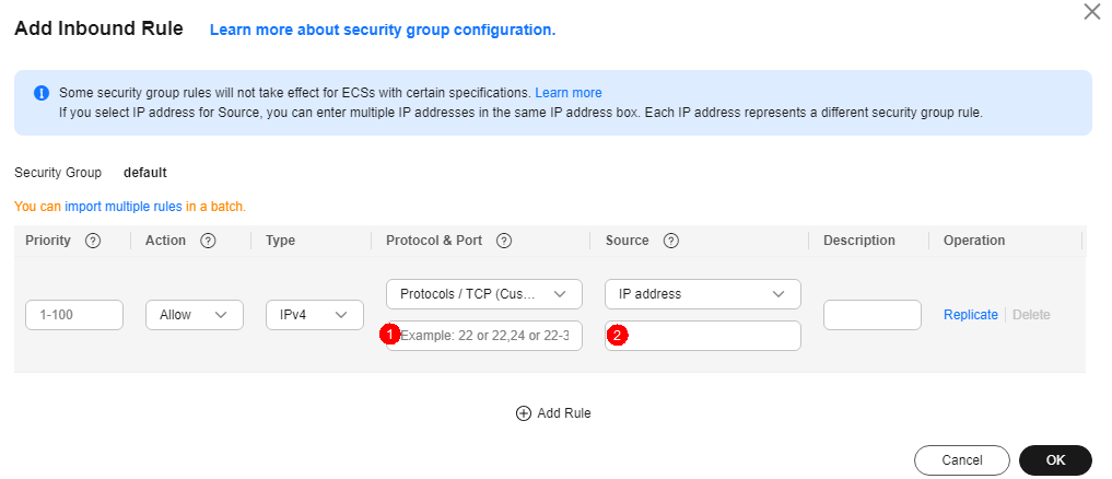

- Configure inbound rules to allow the bastion host to access the proxy server.Figure 1 Inbound rule configuration
- Set Protocol & Port to the default port 1080 for the SOCKS5 proxy server.
- Enter the IP address of the bastion host in the Source text box.

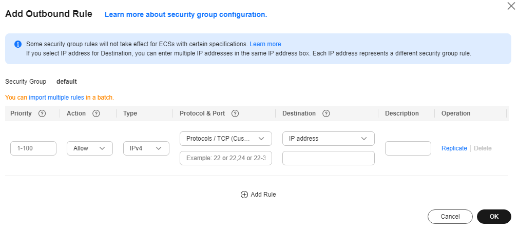

- Configure outbound rules for the proxy server to allow the proxy server to access the service servers managed with CBH.Figure 2 Outbound rule configuration

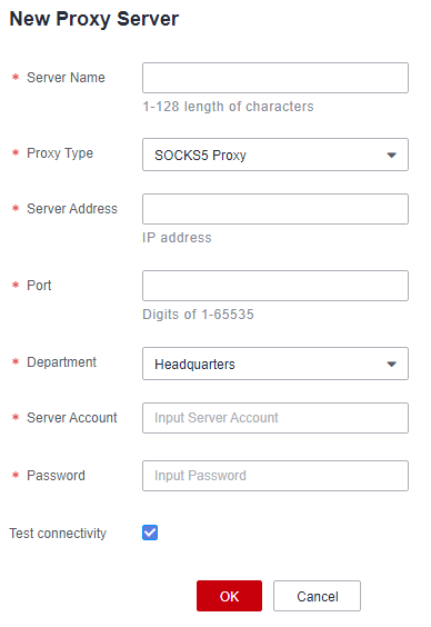

- Use CBH to manage proxy servers. Log in to the CBH system and add the proxy server. For details, see Adding a Host. On the Host page, click the Proxy Server tab and then New.Figure 5 New Proxy Server

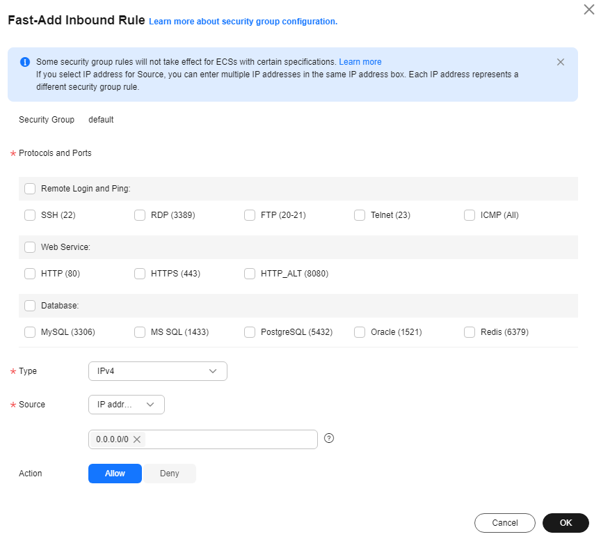

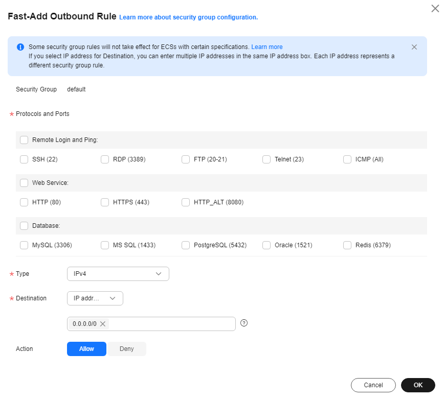

- Go back to the security group (the one you select in 1) your service servers belong to. On the Inbound Rules tab, click Fast-Add Rule.
You can also add some outbound rules as required.

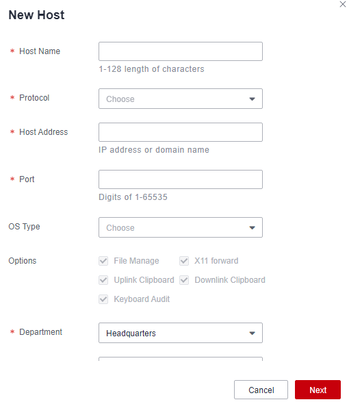

- Use CBH to manage service servers. For details, see Adding Hosts.Figure 6 New Host
