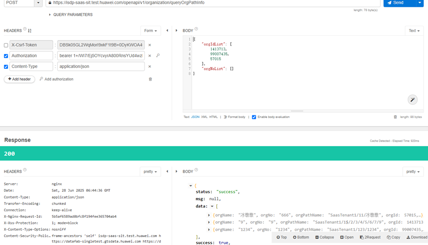

请求示例
    "orgIdList": [
        1413713,
        99007435,
        57015
    "orgNoList": []
响应示例
    "status": "success",
    "msg": null,
    "data": [
            "orgName": "1234",
            "orgNo": "1234",
            "orgPathName": "SaasTenant1/123/1234",
            "orgId": 99007435,
            "orgPathNo": "SaasTenant1/123/1234"
            "orgName": "XXX",
            "orgNo": "666",
            "orgPathName": "SaasTenant1/11/XXX",
            "orgId": 57015,
            "orgPathNo": "SaasTenant1/11/666"
            "orgName": "9",
            "orgNo": "9",
            "orgPathName": "SaasTenant1/1$/2/3/4/5/6/7/9",
            "orgId": 1413713,
            "orgPathNo": "SaasTenant1/1/2/3/4/5/6/7/9"
    "success": true,
    "failed": false
