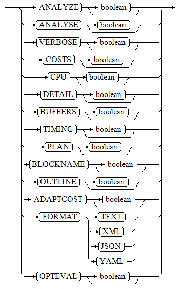

  • 显示SQL语句的执行计划,支持多种选项,对选项顺序无要求。
    EXPLAIN [ (  option  [, ...] )  ] statement;
    其中选项option子句的语法为。
    ANALYZE [ boolean ] |
        ANALYSE [ boolean ] |
        VERBOSE [ boolean ] |
        COSTS [ boolean ] |
        CPU [ boolean ] |
        DETAIL [ boolean ] |
        BUFFERS [ boolean ] |
        TIMING [ boolean ] |
        PLAN [ boolean ] |
        BLOCKNAME [ boolean ] |
        OUTLINE [ boolean ] |
        ADAPTCOST [ boolean ] |
        FORMAT { TEXT | XML | JSON | YAML } |
        OPTEVAL [ boolean ]
