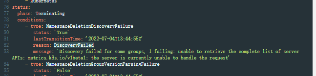

删除命名空间时,命名空间一直处“删除中”状态,无法删除。查看命名空间yaml配置,status中有报错“DiscoveryFailed”,示例如下:
上图中报错信息为:Discovery failed for some groups, 1 failing: unable to retrieve the complete list of server APIs: metrics.k8s.io/v1beta1: the server is currently unable to handle the request
表示当前删除命名空间动作阻塞在kube-apiserver访问metrics.k8s.io/v1beta1接口的APIService资源对象。
