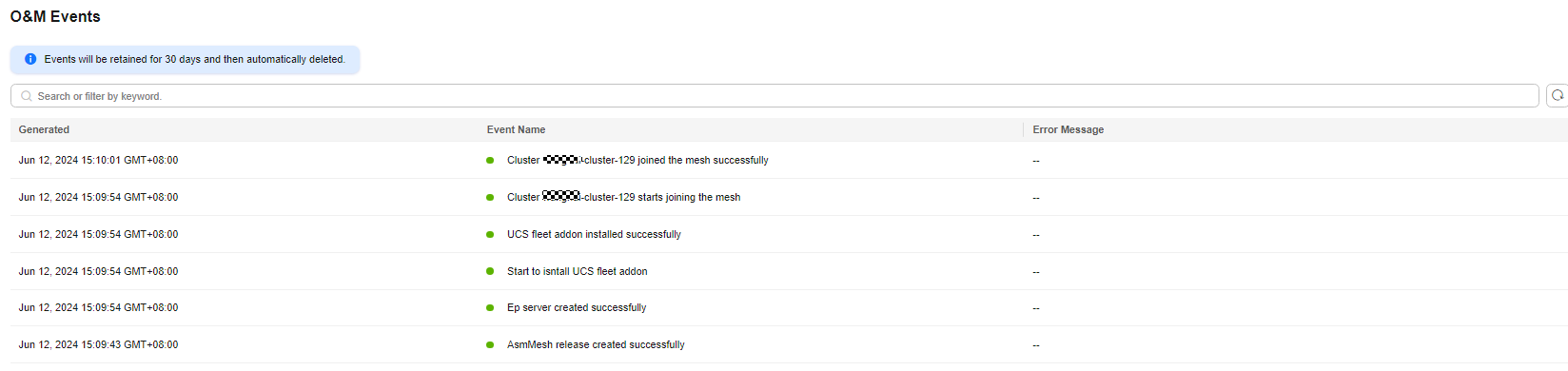

Viewing Events
After the service mesh is enabled, you can view O&M events on the overview page. You need to subscribe to AOM 2.0. For details, see Subscribing to AOM 2.0.
Events will be retained for 30 days and then automatically deleted.
Figure 1 Viewing event details
