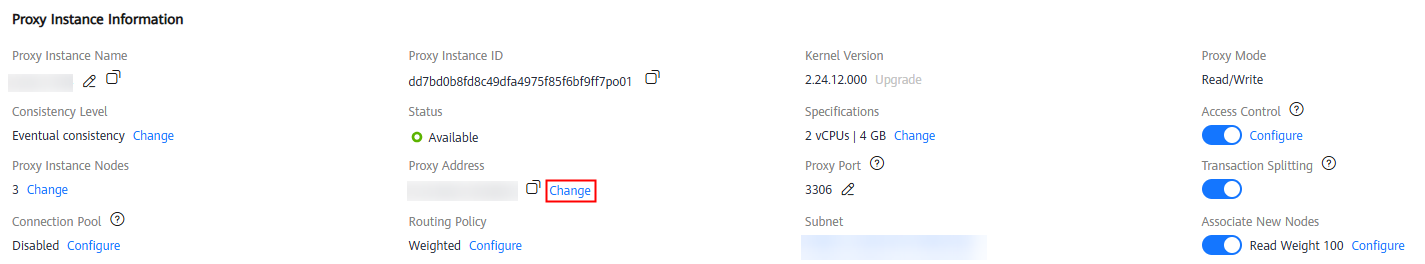

- Click the name of a proxy instance. In the Proxy Instance Information area, click Change under Proxy Address.
Figure 1 Changing a proxy address

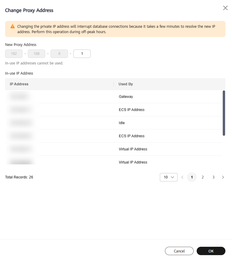

- In the displayed dialog box, enter a new IP address and click OK.
In-use IP addresses cannot be used.
Figure 2 Changing a proxy address
