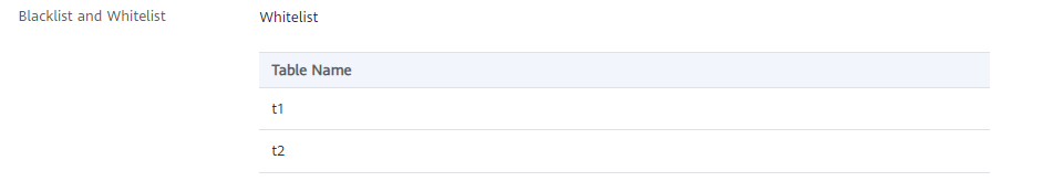

Figure 3 Deleting a table from a synchronization task - Click View again and check that the deleted table is not in the whitelist.
Figure 4 Checking that the deleted table is not in the whitelist

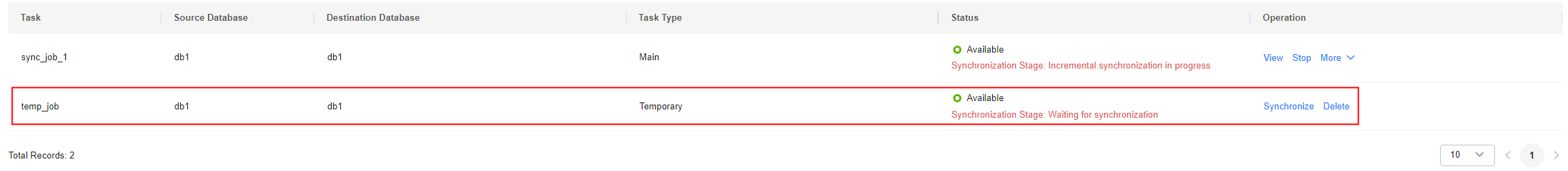

Figure 5 Selecting a table to be added and setting Configure Table Operations - Return to the Data Synchronization page and click Synchronize in the Operation column of the new temporary task.
Figure 6 Synchronizing a temporary task
- Once the temporary task disappears from the list, the table has been synchronized and added to the main task. Click View in the Operation column of the main task to check whether the table is successfully added.

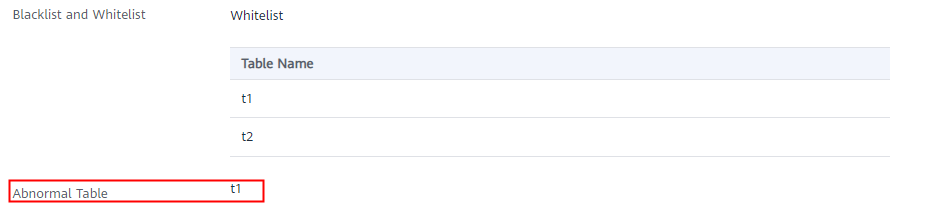

- In the navigation pane, choose Data Synchronization. On the displayed page, view a task. If a table in the task encounters synchronization exceptions, repair it.
Figure 8 Abnormal table t1 found

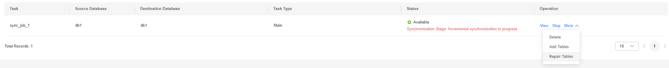

- Return to the Data Synchronization page and choose More > Repair Tables in the Operation column of the task.
Figure 9 Repairing tables

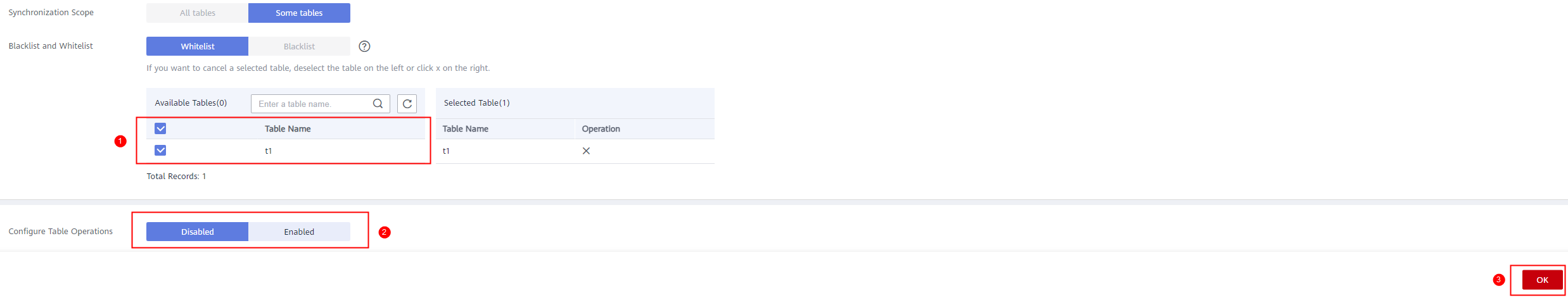

- On the displayed page, select the table to be repaired, set Configure Table Operations as required, and click OK.
Figure 10 Selecting the table to be repaired

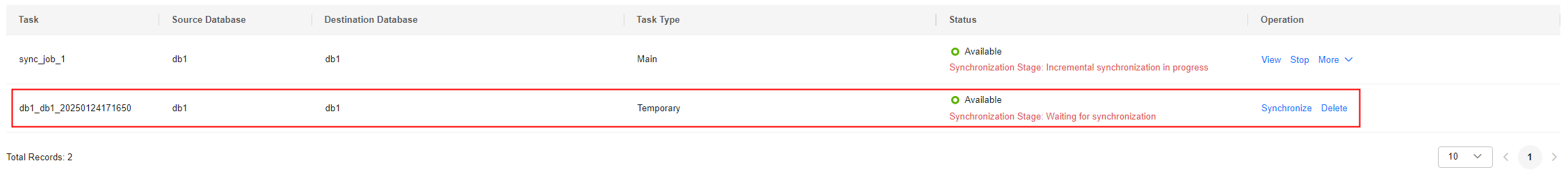

- Return to the Data Synchronization page and click Synchronize in the Operation column of the new temporary task. After the abnormal table is repaired, the temporary task is automatically merged into the main task.
Figure 11 Synchronizing the new temporary task

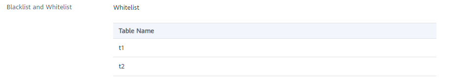

- Once the temporary task disappears, the abnormal table has been repaired. View the main task information and check that there is no abnormal table.
Figure 12 Abnormal table repaired
