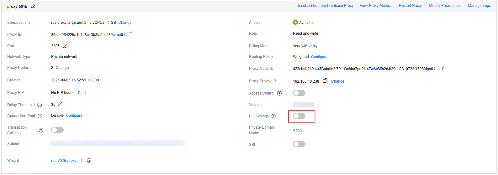

- On the displayed page, click
next to the Pull Binlogs field.

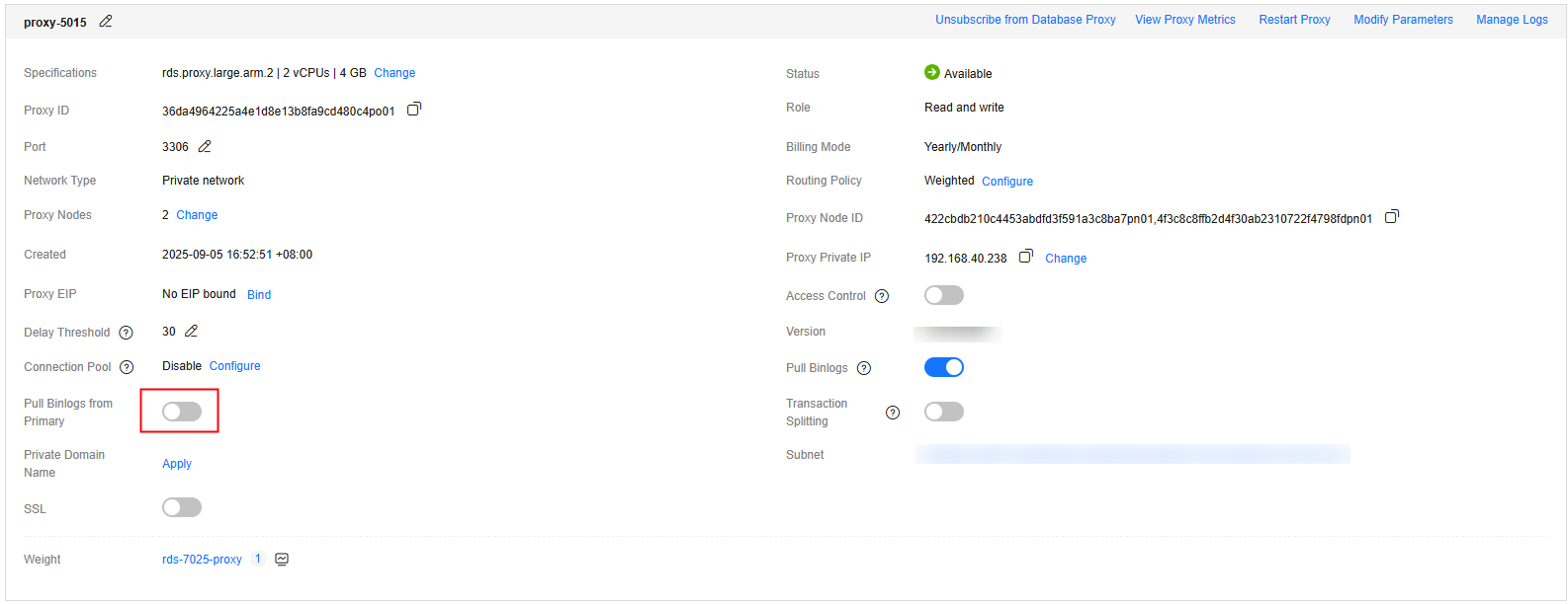

Figure 1 Enabling binlog pulling - For read/write proxies, after Pull Binlogs is enabled, click
next to the Pull Binlogs from Primary field.
- If this function is enabled, binlogs are pulled from the primary instance.
- If this function is disabled, binlogs are pulled from read replicas.
Figure 2 Enabling Pull Binlogs from Primary
