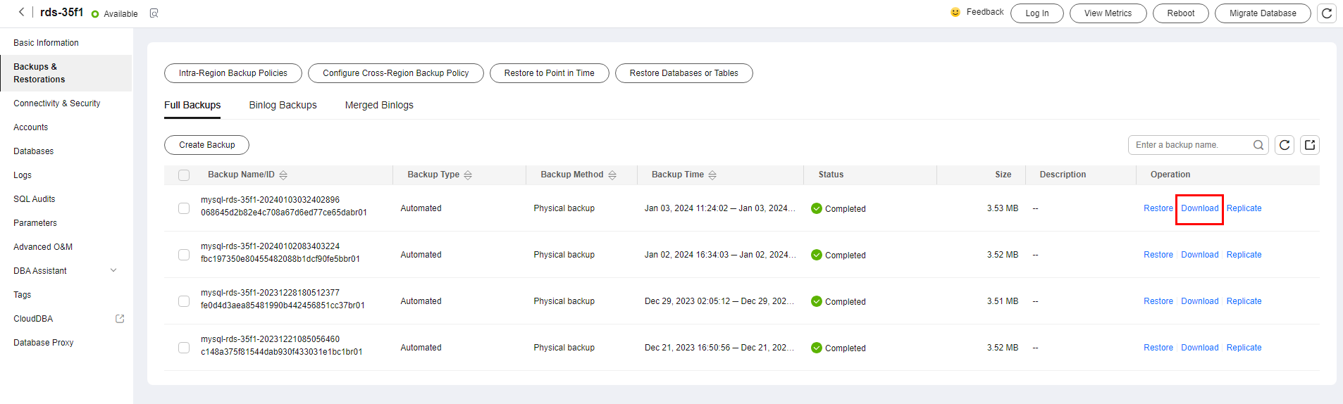

RDS for MySQL DB instances automatically perform full backups at the time you specified. You can also create manual backups for your DB instance. The generated .qp files can be downloaded and restored to an on-premises database.
  1. Click the DB instance name on the RDS console, choose Backups & Restorations > Full Backups, locate the target full backup, and click Download in the Operation column to download the backup.
    Figure 1 Downloading a full backup
