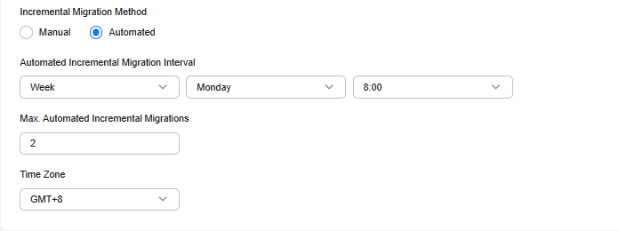

Configuring Incremental Migration Settings
The following table describes the parameters about incremental migration.
Table 7 Configuring incremental migration settings
Parameter
Description
Overwrite Existing During Incremental Migration
See Table 4.
NOTE:
This setting only applies to incremental migration.
Incremental Migration Method
  • Manual: You can manually initiate an incremental migration after the first incremental migration defined in the workflow is complete.
  • Automated: You can define the interval, maximum attempts, and time zone to trigger incremental migrations.
    For example, if you configure the incremental migration settings as shown in the following figure, the system will initiate incremental migration at 08:00 in the morning on Mondays (GMT+08:00) for the next two weeks.
  • If you select Manual, incremental migration will be executed immediately when the workflow reaches the BatchCreateIncrementalMigrationTasks step.
  • If you select Automated, when the workflow reaches the BatchCreateIncrementalMigrationTasks step, you can:
    • Manually trigger incremental migration immediately when you are waiting for automatic incremental migration.
    • Skip incremental migration and verify services.
