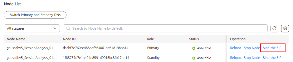

- In the Node List area, click Bind the EIP in the Operation column.
For a distributed instance, switch to CN in the filter area first and then bind an EIP.Figure 1 Binding an EIP (distributed instance)Figure 2 Binding an EIP (centralized instance)

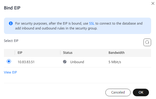

- In the displayed dialog box, all available unbound EIPs are listed. Select the required EIP and click OK.
If no available EIPs are displayed, click View EIP and obtain an EIP.

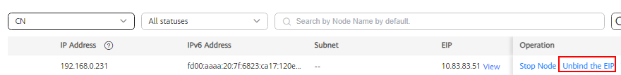

- In the Node List area, click Unbind the EIP in the Operation column.
- For a distributed instance, switch to CN in the filter area first and then click Unbind the EIP in the Operation column.

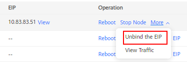

- For a centralized instance, choose More > Unbind the EIP in the Operation column.
Figure 5 Unbinding an EIP (distributed instance)Figure 6 Unbinding an EIP (centralized instance) - In the displayed dialog box, click OK to unbind the EIP.
