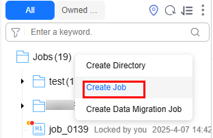

- In the job directory list, right-click a directory and select Create Job. Figure 1 Creating a job
