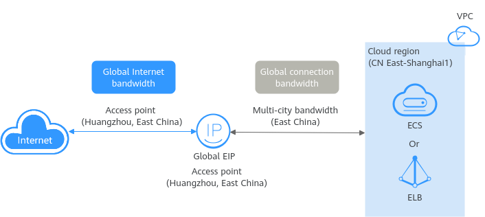

Multi-city Bandwidth Application Scenario (Global EIP)
In this example, a global EIP is bound to an ECS.
The ECS is in the CN East-Shanghai1 region, and the access point of the global EIP is in Hangzhou, a city in East China.
Figure 1 Multi-city bandwidth application scenario (global EIP)

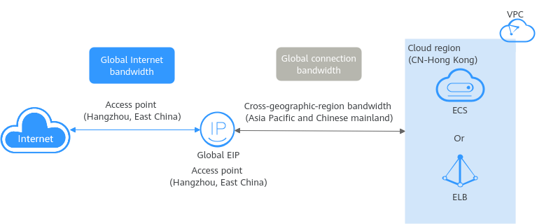

Cross-Geographic-Region Bandwidth Application Scenario (Global EIP)
The ECS is in the CN-Hong Kong region, and the access point of the global EIP is in Hangzhou. CN-Hong Kong is a cloud region in Asia Pacific, but Hangzhou is a city on the Chinese mainland.
  • Geographic region 1: Asia Pacific, the geographic region where the ECS is located
  • Geographic region 2: Chinese mainland, the geographic region where the global EIP is accessed
Ensure that the geographic regions 1 and 2 are configured as above.
Figure 3 Cross-geographic-region bandwidth application scenario (global EIP)

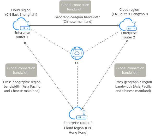

Geographic-Region or Cross-Geographic-Region Bandwidth Application Scenario (Central Network)
In this example, enterprise routers are connected over a cloud connection.
  • Enterprise router 1 in CN East-Shanghai1 and enterprise router 2 in CN South-Guangzhou are from the same geographic region. A geographic-region bandwidth can be used for communication between the two enterprise routers.
  • Enterprise router 1 in CN East-Shanghai1 and enterprise router 3 in CN-Hong Kong are in different geographic regions. A cross-geographic-region bandwidth can be used for communication between the two enterprise routers.
    • Geographic region 1: Chinese mainland, geographic region where enterprise router 1 is located
    • Geographic region 2: Asia Pacific, geographic region where enterprise router 3 is located
    Ensure that both the geographic regions of enterprise router 1 and enterprise router 3 have been configured.
  • Enterprise router 2 in CN South-Guangzhou and enterprise router 3 in CN-Hong Kong are in different geographic regions. A cross-geographic-region bandwidth can be used for communication between the two enterprise routers.
    • Geographic region 1: Chinese mainland, geographic region where enterprise router 2 is located
Figure 4 Geographic-region or cross-geographic-region bandwidth application scenario (central network)
