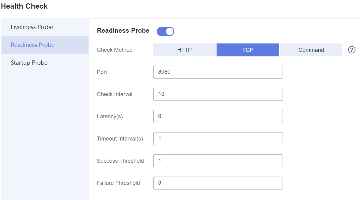

- Readiness probe checks the startup health of application instances. The application instances are available to provide services. Click
next to Readiness Probe to configure the check method. In this example, the readiness probe must be enabled.
- Startup probe checks the running health of application instances. If application instances are unhealthy, CAE restarts them. Click
next to Startup Probe to configure the check method.
Figure 2 Readiness probe

TCP
Port
Port for TCP connections. In this example, select TCP.

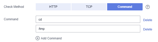

Command
Command
Add a command. Click Add Command to add more commands.
NOTE:
No space is allowed after the command line.
Table 2 Common parameters of the three check methods Parameter
Description
Check Interval
Detection interval, in seconds.
Default value: 10. Minimum value: 1. In this example, use the default value.
Latency
Maximum latency, in seconds.
Default value: 0. Minimum value: 0. In this example, use the default value.
NOTE:
If you configure health check before starting the container, set Latency to 3 minutes.
Timeout Interval
Detection timeout interval, in seconds.
Default value: 1. Minimum value: 1. In this example, use the default value.
Success Threshold
Health check is passed after a specified number of consecutive successful detections.
Default value: 1. Minimum value: 1. For liveliness and startup probes, set it to 1. In this example, use the default value.
Failure Threshold
Health check fails after a specified number of consecutive failed detections.
Default value: 3. Minimum value: 1. In this example, use the default value.

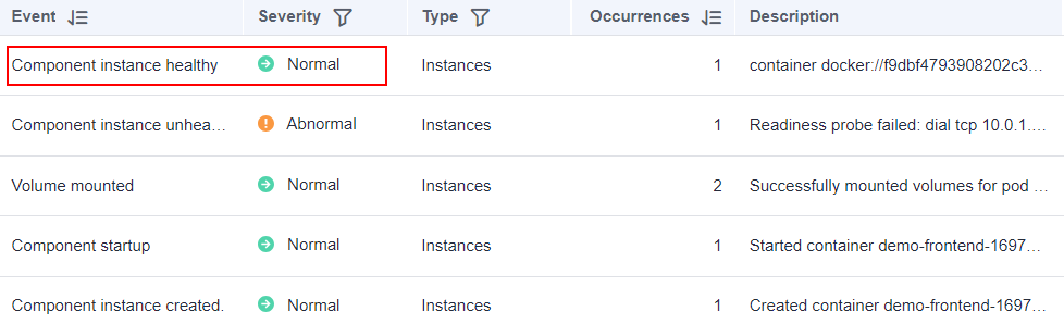

- After upgrading the component, choose Component Events. If the Component instance healthy event is Normal, the component is successfully upgraded.
Figure 3 Component health check
