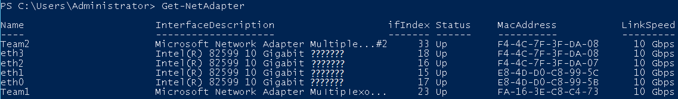

  2. On the Windows PowerShell CLI of the BMS, run the following command to check the NIC information:
    Get-NetAdapter
    Information similar to the following is displayed.
    Among the devices, eth0 and eth1 bear the VPC, and eth2 and eth3 bear the user-defined VLAN. The following steps use eth2 and eth3 to configure a user-defined VLAN.
