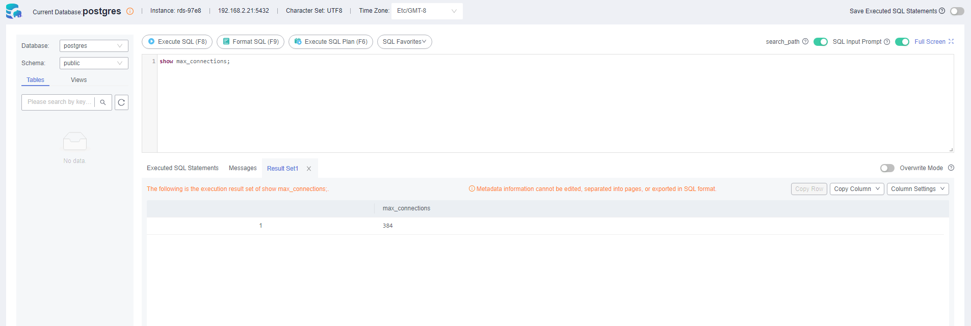

- To query the maximum number of connections allowed, run the following command:
show max_connections;
