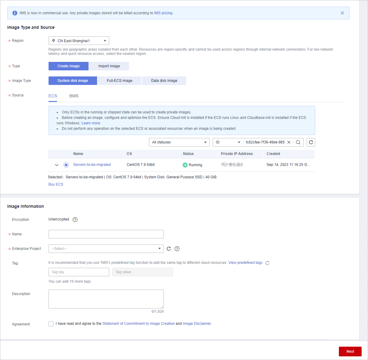

 - Locate the ECS whose OS is to be migrated and choose More > Manage Image > Create Image in the Operation column.
 - On the Create Image page, configure the following parameters:
- Region: Retain the default value.
 - Type: Retain the default value.
 - Image Type: Retain the default value.
 - Source: Retain the default value.
 - Name: Enter an image name that is easy to identify.
 - Agreement: Read the agreements and select the Agreement option.
Figure 2 Configuring image information
     - Click Next.
 - Confirm the image information and click Submit.

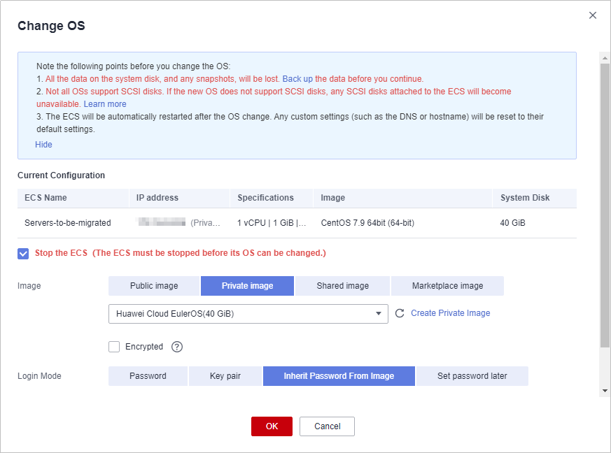

 - Switch back to the ECS console, locate the ECS whose OS is to be changed, and choose More > Manage Image > Change OS in the Operation column.
 - In the Change OS dialog, configure the following parameters:
- Select Stop the ECS.
 - Image: Select Private image.
 - Login Mode: Select Password.
Figure 3 Configuring parameters
     - Click OK and complete the verification as prompted.
 - Read and select the statement, and click OK.
After the switchover, the OS name on the console is changed to Huawei Cloud EulerOS.
