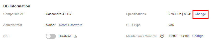

 - In the DB Information area on the Basic Information page, click Change next to Specifications.
     Figure 1 Changing specifications

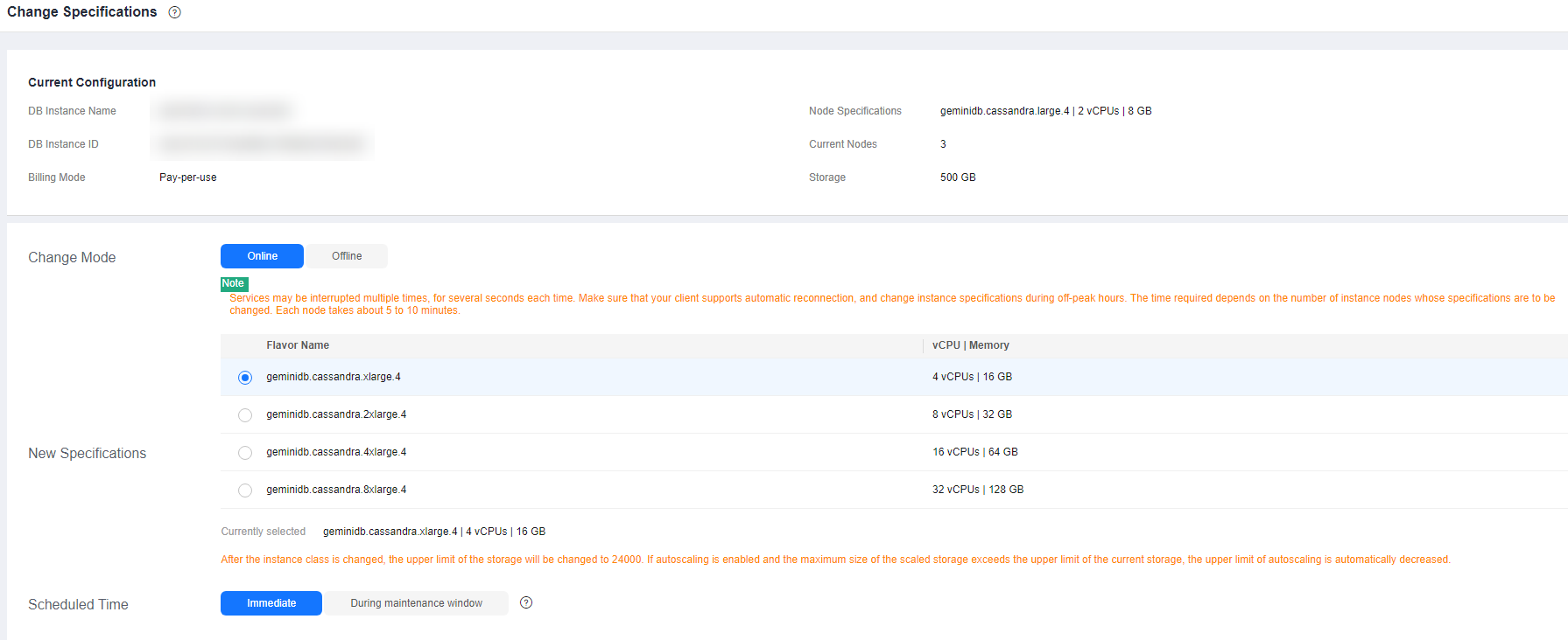

      - On the displayed page, select the required specifications and click Next.
     Figure 2 Changing specifications

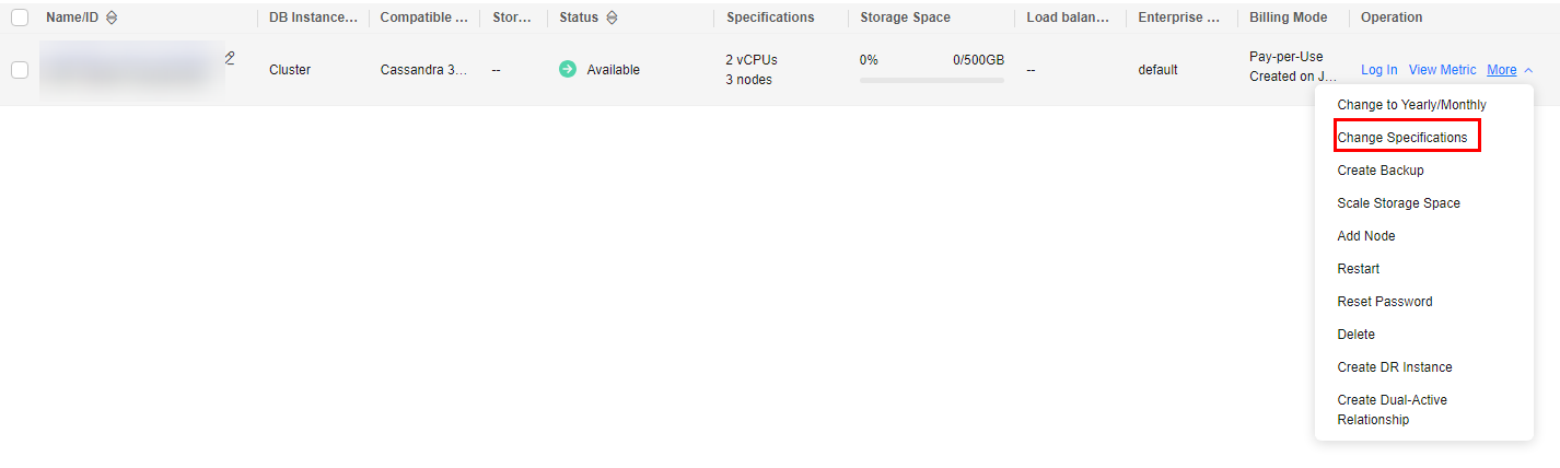

 - On the Instances page, locate the instance whose specifications you want to change and choose  in the Operation column.
     Figure 3 Changing specifications
     Figure 4 Changing specifications
