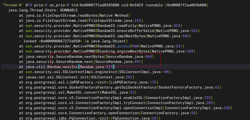

When JDBC establishes a connection in SSL mode, a strong random number is obtained on the client. During the connection establishment, the following error information may be reported.
Scenario 1: Error report.
Scenario 2: The connection is blocked. If loginTimeout is set in the URL connection string, the message "Connection attempt timed out" is displayed. If this parameter is not set, the connection is blocked.

The random number generation on the client is too slow to meet product requirements. The entropy source is insufficient. As a result, the service fails to be started. This problem exists in some Linux environments.
