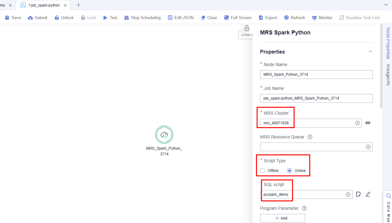

    To reference the created script in a job, perform the following steps:
  6. Create a batch processing pipeline job.
  7. Open the job, drag an MRS Spark Python node to the canvas, and configure parameters for the node.
    MRS Cluster: Select the cluster you selected when creating the connection in Management Center.
    Select Online for Script Type and then select the pyspark_demo script you have created.
    Retain the default settings for other parameters.
    Figure 2 Configuring node parameters

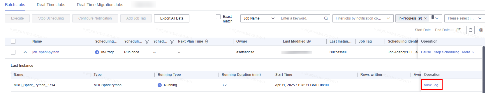

    Figure 3 Viewing the execution result
  11. On the Job Monitoring page, view the job scheduling status and log.
