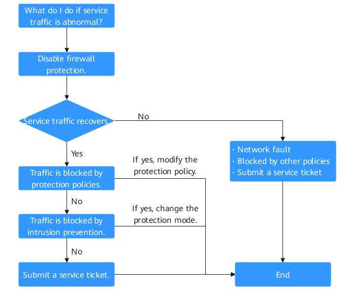

Troubleshooting Methods
Figure 1 Procedure of checking traffic exceptions
Table 1 Procedure of checking traffic exceptions
No.
Possible Cause
Solution
Traffic interruption not caused by CFW
See Cause 1: Traffic Interruption Not Caused by CFW.
2
Traffic blocked by protection policies
See Cause 2: Traffic Blocked by Protection Policies.
3
Traffic blocked by intrusion prevention
See Cause 3: Traffic Blocked by Intrusion Prevention.
Log in to the CFW console and perform the following steps:
  1. Disable protection.
  2. Observe the service running status.
    • If the service is restored, it indicates traffic was blocked by CFW. Rectify the fault by referring to Cause 2: Traffic Blocked by Protection Policies and Cause 3: Traffic Blocked by Intrusion Prevention.
    • If the fault persists, the traffic interruption is not caused by CFW. Possible fault causes include:
      • Network fault: The route configuration is incorrect, or the NE is faulty.
      • Policy-based interception: Interception caused by incorrect configurations of other security services, network ACLs, or security groups.
      If you need assistance from Huawei Cloud, you can create a service ticket.

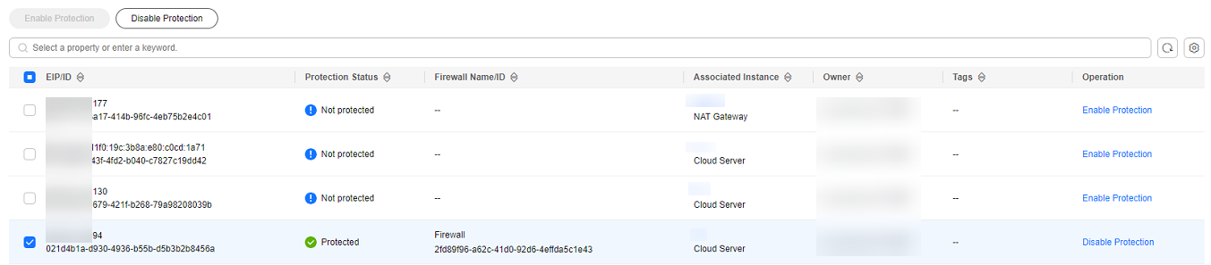

  1. To ensure that the IP address can be used for external communication during fault locating, the firewall administrator logged in to the firewall console, and chose Assets > EIPs, and disables protection for the EIP.
    During the firewall is disabled, the traffic of the EIP is not processed and related logs are not displayed.

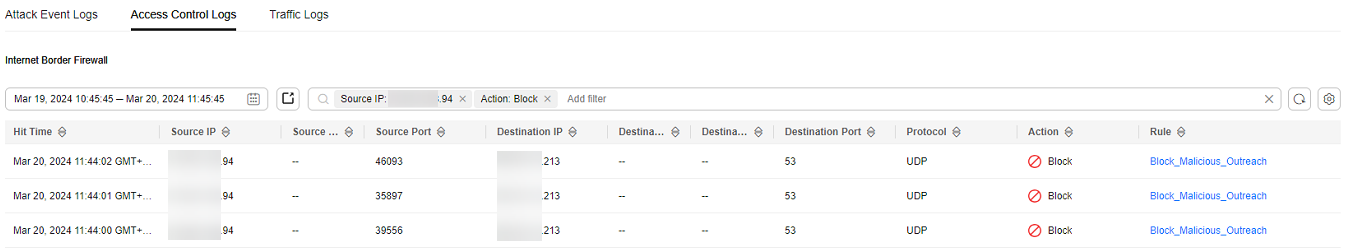

  2. The administrator chose Log Audit > Log Query and clicked the Access Control Logs tab. He searched for the blocking logs of the access source IP address xx.xx.xx.94. A blocking rule named Block-Malicious-Outreach was found, and this rule blocked the traffic from the attack source IP address to the Internet.

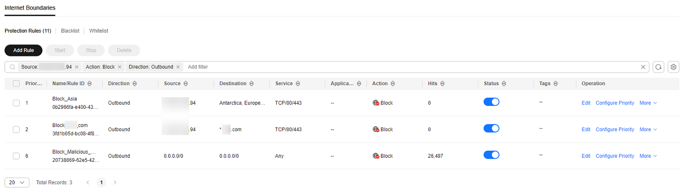

  3. The administrator searched for "Source: xx.xx.xx.94; Action: Block; Direction: Outbound; Status: Enabled" in the access control policy list. Three available policies that contain the IP address were found.
    The policy contained the Block-Malicious-Outreach blocking rule. According to the value of the Hits column, a large number of sessions have been blocked.
    Figure 4 Searching for a protection rule
    According to Figure 4, there were three valid rules whose source IP addresses contain xx.xx.xx.94, including Block-xxx-com (with the highest priority), Block-Malicious-Outreach, and Allow-Asia (with the lowest priority). Besides the blocking rule Block-Malicious-Outreach, the administrator checked whether the two other two rules may intercept normal services.
    Finally, it is found that the EIP accessed suspicious IP addresses so that an administrator configured a blocking rule it, but the configured destination was incorrect. As a result, all external traffic is blocked by mistake (see the second protection rule in Figure 4).
  4. The administrator changed the destination address to a specific IP address that needs to be blocked, and enabled protection for the EIP on the Assets > EIPs page of the firewall console. After protection was restored, the traffic of the EIP was normally forwarded by CFW.

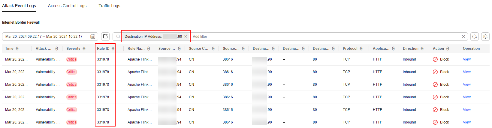

The O&M personnel of a company found that a service on the server whose IP address was xx.xx.xx.90 cannot be accessed. It was suspected that the service was blocked by the firewall.
The firewall administrator took the following measures:
  1. To quickly recover the service, the administrator logged in to the firewall console, choose Attack Defense > Intrusion Prevention, and changed the protection mode from Intercept mode - strict to Observe.
    During this period, the firewall did not intercept attack traffic but only logged the attack traffic.
  2. The administrator chose Log Audit > Log Query and clicked the Attack Event Logs tab. The logs about the access to the destination IP address xx.xx.xx.90 were displayed. The IPS rule whose ID was 331978 blocked the traffic.
    Figure 5 Filtering attack event logs

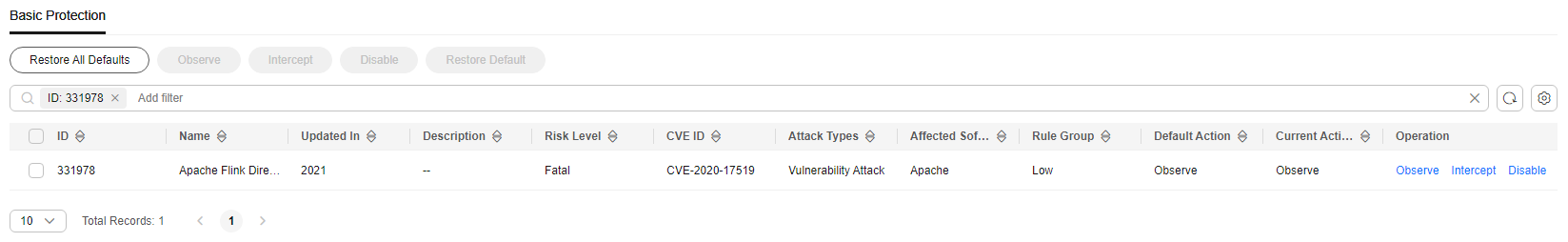

  3. The administrator clicked Details in the Operation column, clicked Payload Content in the display page, and created a packet capture task to verify that the service is normal. The administrator searched for the rule whose ID is 331978 from the list on the Basic Protection tab page by referring to Modifying the Action of a Basic Protection Rule.
    Figure 6 Rule 331978
  4. The administrator clicked Observe in the Operation column. This rule did not block the traffic matching the signature but only logged the traffic.
  5. The administrator set the protection mode to Intercept mode - strict and went to the Basic Protection tab to confirm that the Current Status of the rule 331978 was still Observe.
