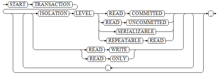

Format 1: START TRANSACTION
START TRANSACTION
       ISOLATION LEVEL { READ COMMITTED | READ UNCOMMITTED | SERIALIZABLE | REPEATABLE READ }
       | { READ WRITE | READ ONLY }

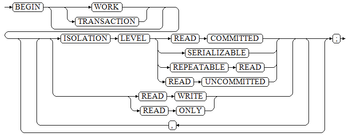

Format 2: BEGIN
BEGIN [ WORK | TRANSACTION ]
       ISOLATION LEVEL { READ COMMITTED | SERIALIZABLE | REPEATABLE READ | READ UNCOMMITTED }
