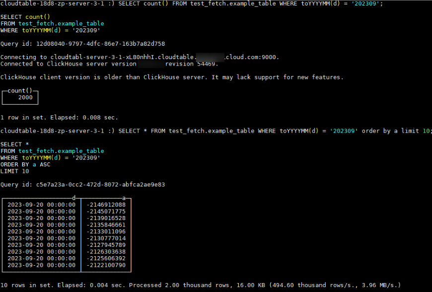

  • Step 3: Verify the result.
    1. Check the number of data rows and sample data content.
      SELECT count() FROM test_fetch.example_table WHERE toYYYYMM(d) = '202309';
      SELECT * FROM test_fetch.example_table WHERE toYYYYMM(d) = '202309' order by a limit 10;
      Results display
