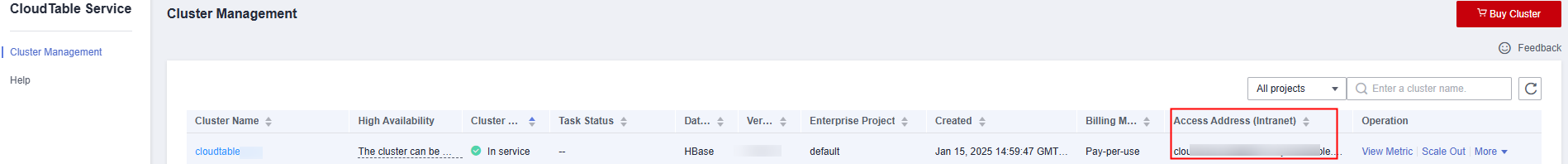

  3. Obtain a cluster access address.
    Choose Cluster Management in the navigation pane. In the cluster list, locate the required cluster and obtain the address in the Access Address (Intranet) column. The parameter value is the cluster access address, as shown in Figure 1.
    Figure 1 Access address
