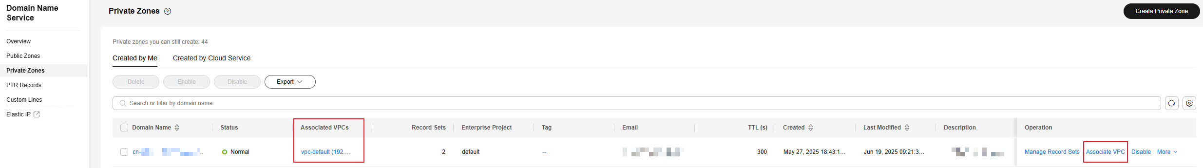

  1. Associate a VPC with the private domain name and add record sets.
    Log in to the DNS console and associate a VPC with the private domain name.
    Figure 1 Associating a VPC with the private domain name

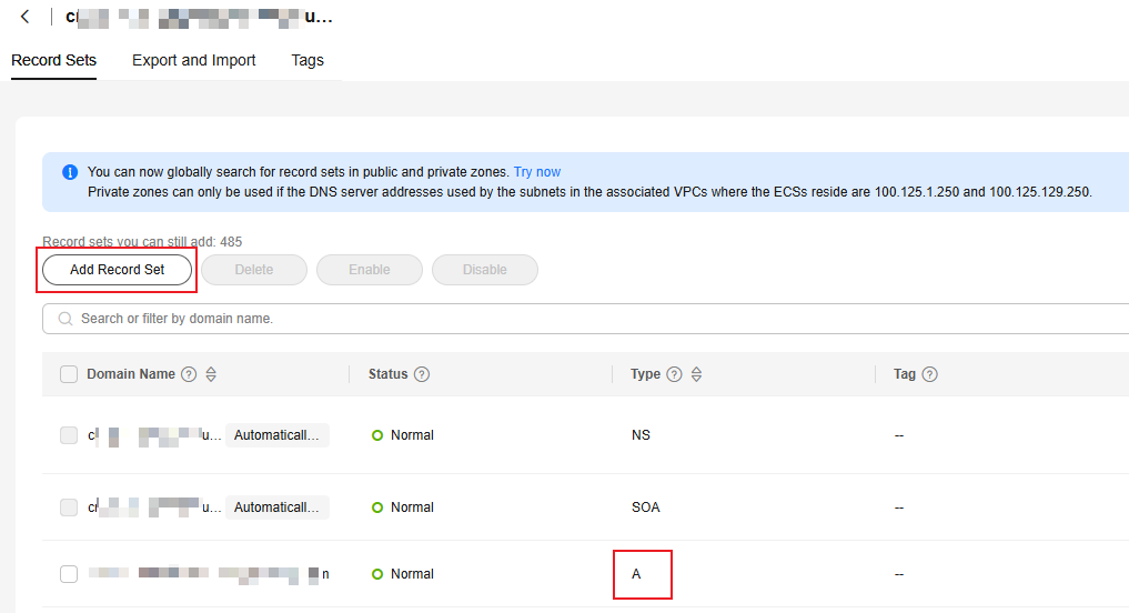

    Click the domain name, and add a type A record set.
    Figure 2 Adding a record set

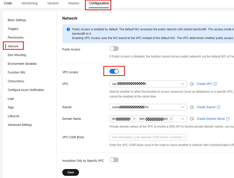

  4. Configure the function.
    On the details page of the function created in 2, click the Configuration tab and configure the following settings:
    1. For Permissions, select the agency created in 3.
    2. Enable VPC access and select the created VPC, subnet, and domain name. For details, see Figure 3.
    Figure 3 Configuring the function
