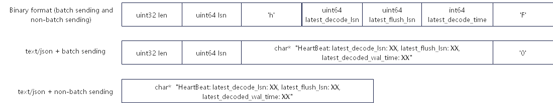

  • enable-heartbeat:
    Specifies whether to generate heartbeat logs. This option is valid only for streaming decoding.
    Value range: Boolean. The default value is false.
    • true: Heartbeat logs are generated.
    • false: Heartbeat logs are not generated.
    If the heartbeat log output option is enabled, heartbeat logs will be generated. The following uses parallel decoding as an example to describe how to parse heartbeat logs: For a binary heartbeat log message, it starts with a character 'h' and then the heartbeat log content: an 8-byte uint64 string, an 8-byte uint64 string, and an 8-byte int64 string. For the first 8-byte uint64 string, in the decoding scenario where DNs are directly connected, this string is an LSN, indicating the end position of the WAL read when the heartbeat logical log is sent; in the decoding scenario where distributed strong consistency is required, this string is a CSN, indicating the decoding log transaction CSN that has been sent when the heartbeat logical log is sent. For the second 8-byte uint64 string, in the decoding scenario where DNs are directly connected, this string is an LSN, indicating the location of the WAL that has been flushed to disks when the heartbeat logical log is sent; in the decoding scenario where distributed strong consistency is required, this string is a CSN, indicating the CSN to be obtained by the next transaction committed by the cluster. The last 8-byte int64 string indicates the generation timestamp (starting from January 1, 1970) of the latest decoded transaction log or checkpoint log. Then, it ends with character 'F'. TEXT/JSON heartbeat log messages that are sent in batches end with '0'. There is no such terminator for each TEXT/JSON heartbeat log message. The message content is transmitted in big-endian mode. The following figure shows the format. (In consideration of forward compatibility, the LSN naming mode is retained. The actual meaning depends on the specific scenario.)

  • decode-style:
    If enable-ddl-json-format is set to true, the decoding format of DDL statements is controlled by enable-ddl-json-format, and decode-style specifies only the decoding format of DML statements. If enable-ddl-json-format is set to false, decode-style specifies the decoding format of both DML and DDL statements.
    Value range: 'j', 't', or 'b' of the char type, indicating the JSON, TEXT, or binary format, respectively.
    Default value:
    • If decode-style is not specified:
      For replication slot plug-ins mppdb_decoding and sql_decoding, the default value of decode-style is 'b', indicating decoding in binary format. For replication slot plug-ins parallel_binary_decoding, parallel_json_decoding, and parallel_text_decoding, the default values of decode-style are 'b', 'j', and 't' respectively, indicating decoding in binary, JSON, and TEXT formats, respectively.
    • If decode-style is specified:
      Decoding is performed based on the specified decoding style.
    For the JSON and TEXT formats, in the decoding result sent in batches, the uint32 consisting of the first four bytes of each decoding statement indicates the total number of bytes of the statement (the four bytes occupied by the uint32 are excluded, and 0 indicates that the decoding of this batch ends). The 8-byte uint64 indicates the corresponding LSN (begin corresponds to first_lsn, commit corresponds to end_lsn, and other values correspond to the LSN of the statement).
    Take the mppdb_decoding plug-in as an example. When decode-style is set to b, decoding is performed in binary format. The result is as follows:

  • sending-batch:
    Specifies whether to send messages in batches.
    Valid value: 0 or 1 of the int type. The default value is 0.
    • 0: The decoding results are sent one by one.
    • 1: When the accumulated size of decoding results reaches 1 MB, decoding results are sent in batches.
    In the scenario where batch sending is enabled, if the decoding format is 'j' or 't', before each original decoding statement, a uint32 number is added indicating the length of the decoding result (excluding the current uint32 number), and a uint64 number is added indicating the LSN corresponding to the current decoding result.
In the CSN-based decoding scenario (that is, output-order is set to 1), batch sending is limited to a single transaction (that is, if a transaction has multiple small statements, the statements can be batch sent). That is, multiple transactions are not sent in the same batch, and BEGIN and COMMIT statements are not batch sent.
