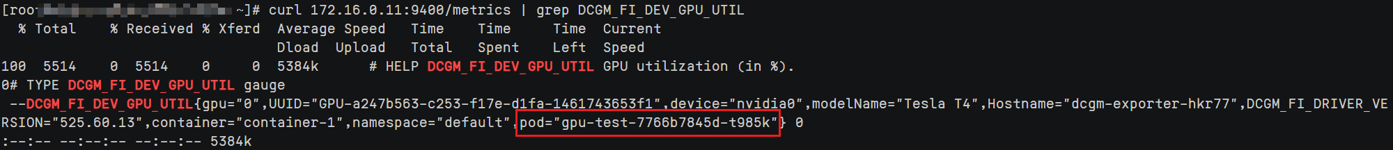

    2. Call the DCGM-Exporter API and verify the collected GPU information.
      172.16.0.11 indicates the pod IP address of the DCGM-Exporter component.
      curl 172.16.0.11:9400/metrics | grep DCGM_FI_DEV_GPU_UTIL

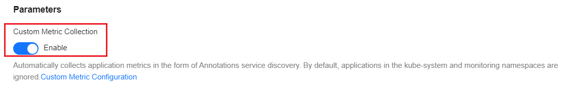

  3. Enable custom metric collection for the Cloud Native Cluster Monitoring add-on.
    1. Log in to the CCE console and click the cluster name to access the cluster console.
    2. In the navigation pane, choose Add-ons, locate the Cloud Native Cluster Monitoring add-on, and click Edit.
    3. In the Parameters area, enable Custom Metric Collection.
    4. Click OK.

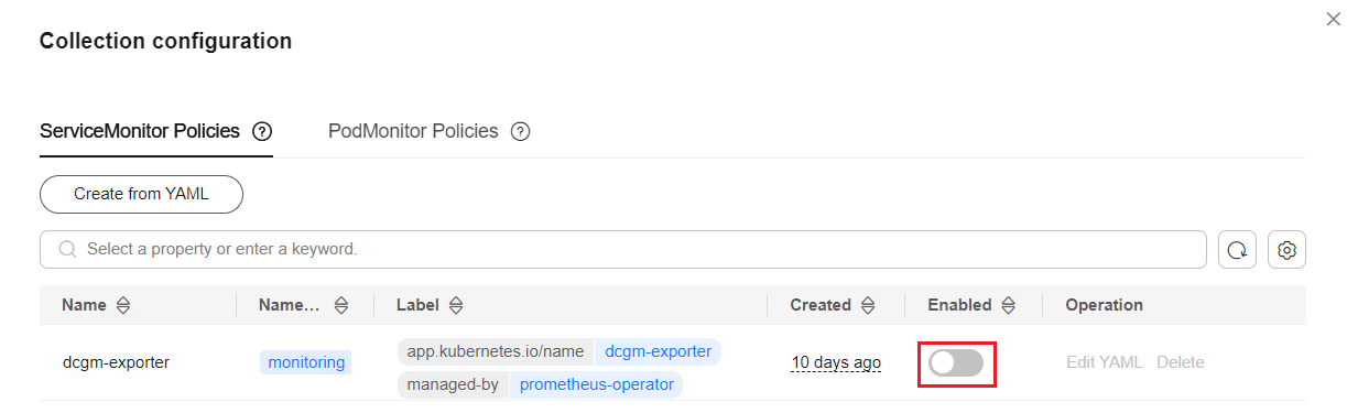

  4. Enable metric collection for the DCGM-Exporter component.
    2. In the navigation pane, choose Settings. Then, click the Monitoring tab.
    3. In the Collection configuration area, click the ServiceMonitor Policies tab and click Manage.
    4. Find the ServiceMonitor policy of the DCGM-Exporter component and enable it.

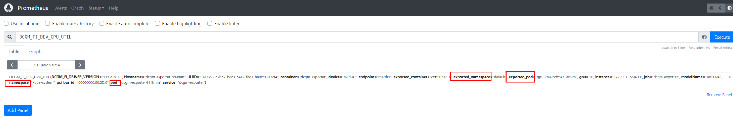

  5. View the metric monitoring information on Prometheus.
    After Prometheus and the related add-on are installed, Prometheus creates a ClusterIP Service by default. To expose Prometheus to external systems, create a NodePort or LoadBalancer Service for it. For details, see Monitoring Custom Metrics Using Cloud Native Cluster Monitoring.
    You can view the GPU utilization and other metrics on a GPU node, as shown in the figure below. For more GPU metrics, see Observable Metrics.

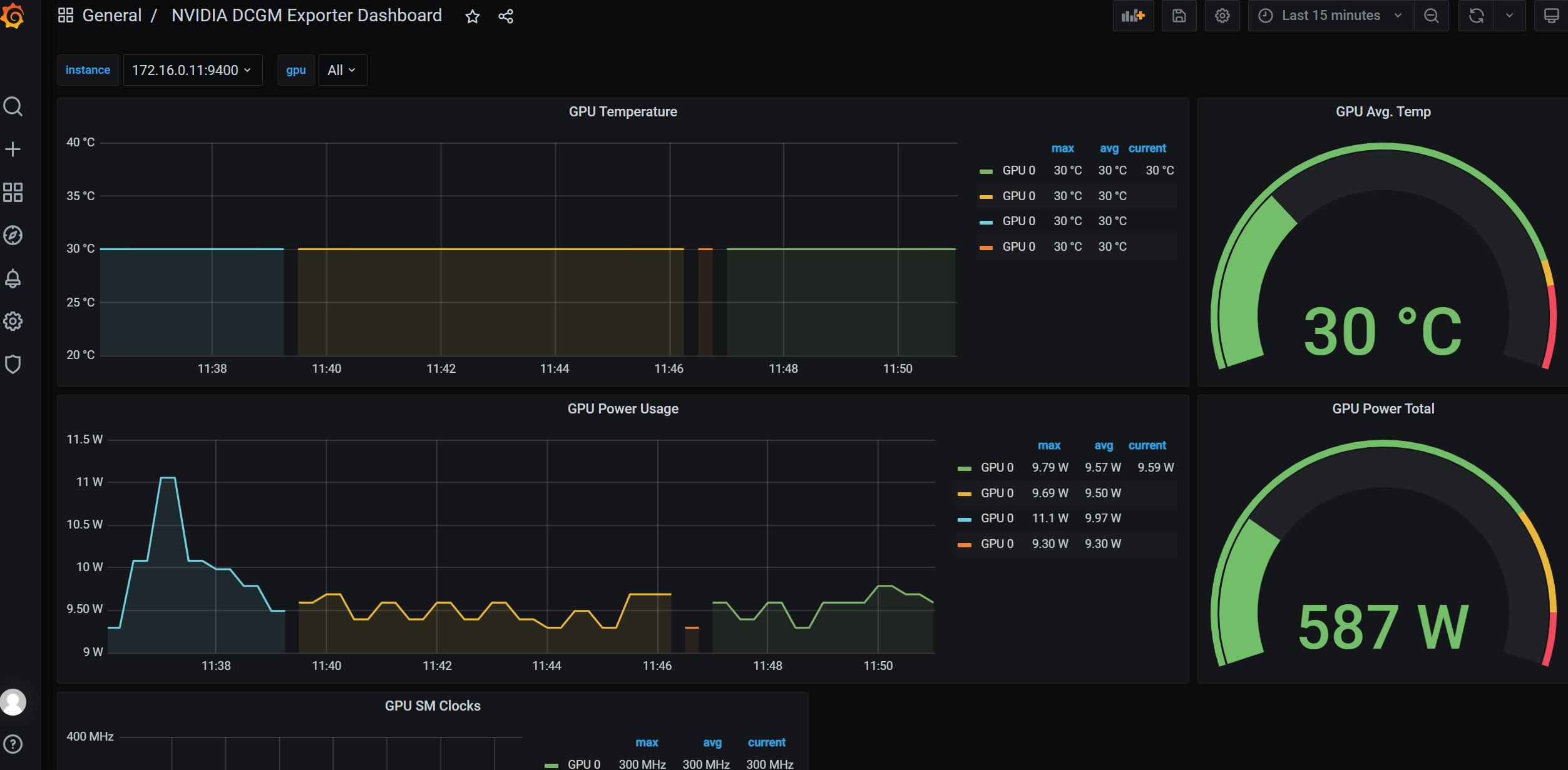

  6. Log in to Grafana and view the GPU information.
    If you have installed Grafana, you can import the NVIDIA DCGM Exporter Dashboard to display GPU metrics.
    For details about how to import dashboards to Grafana, see Manage dashboards.
  6. View the metric monitoring information on Prometheus.
  7. Log in to Grafana and view the GPU information.
