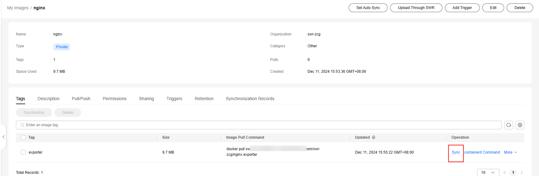

Manually Synchronizing an Image
  1. Log in to the SWR console.
  2. In the navigation pane, choose My Images. Then, click the image name to go to the details page.
  3. On the Tags tab, locate the image tag to be synchronized and click Sync in the Operation column. Select a target region and organization and determine whether to overwrite existing image tags. Click OK.
  4. On the Synchronization Records tab of the image details page, you can view the details of each synchronization task, including the start time, image tag, task status, type, and duration.
