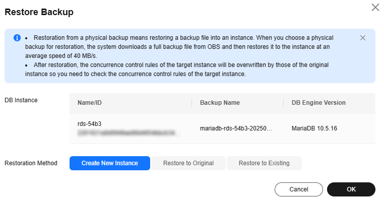

- Select a restoration method.
- Create New Instance
Select Create New Instance for Restoration Method and click OK. The Create New Instance page is displayed.

Figure 1 Restoring to a new instance
