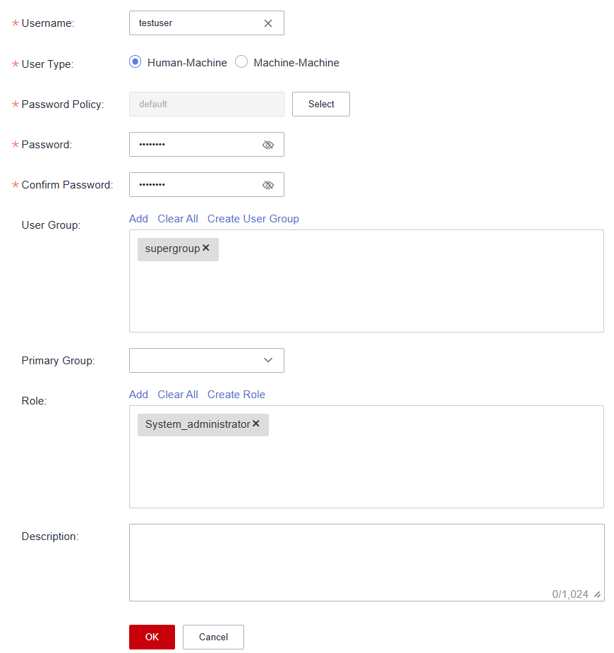

The following describes how to create a human-machine user testuser and associate it with the user group supergroup and role System_administrator.
Figure 2 Adding a cluster user

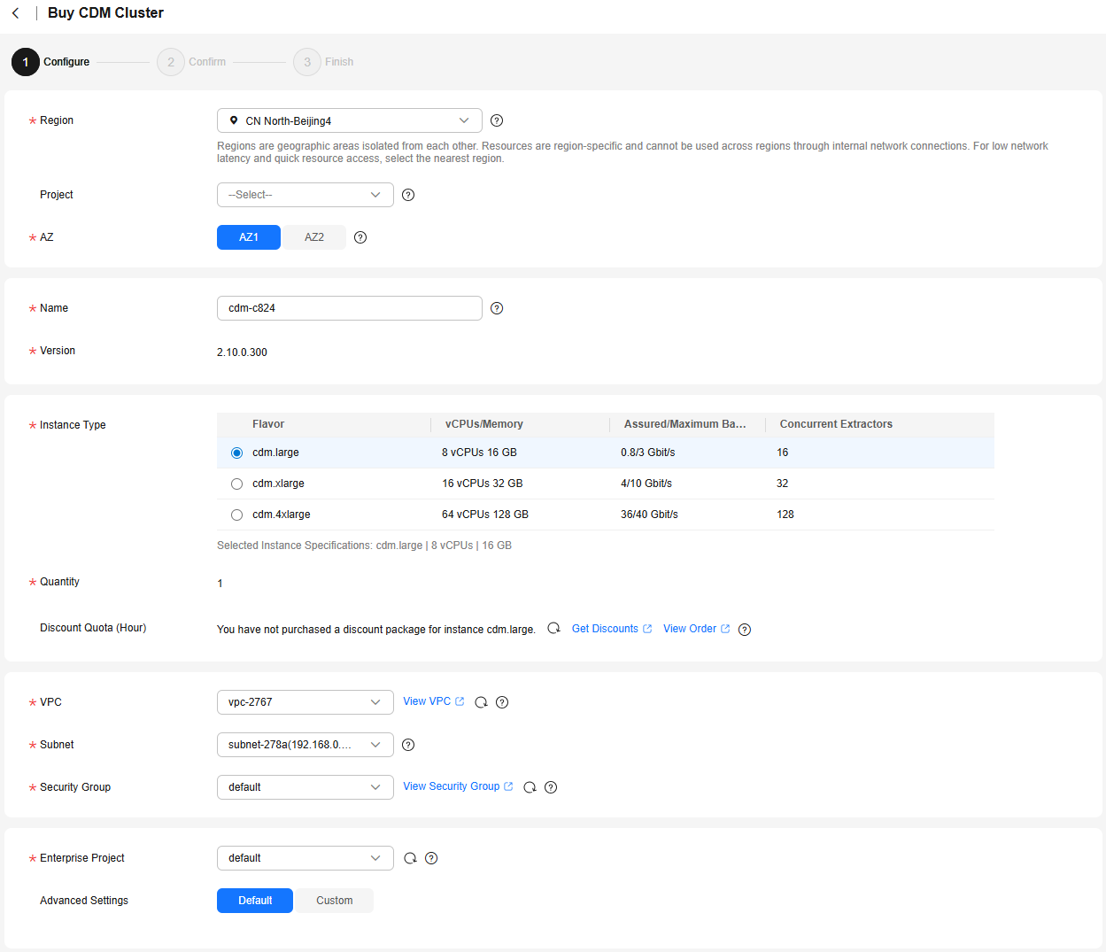

The free CDM cluster provided by a premium DataArts Studio instance can serve as the agent for managing data connections in Management Center. If you purchased a premium DataArts Studio instance in Step 1, skip this step.
The CDM cluster and the MRS cluster must be in the same region and AZ, use the same VPC and subnet, and share the same security group or can communicate with each other.
For how to create a CDM cluster, see Buying a DataArts Migration Incremental Package.
Figure 3 Creating a CDM cluster

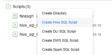

 - On the Develop Script page, right-click the Scripts directory and select Create Hive SQL Script from the shortcut menu.
     Figure 4 Creating a Hive SQL script

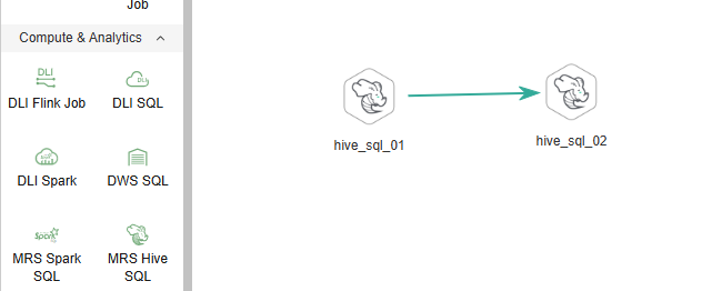

 - Go to the job orchestration page.
Drag the required nodes from the node library on the left to the canvas, move the cursor to a node icon, and click the node to configure its attributes.
In this example, two MRS Hive SQL nodes are configured and connected. When the job is executed, the system executes the two specified SQL scripts in sequence.
Figure 5 Orchestrating a DataArts Studio job

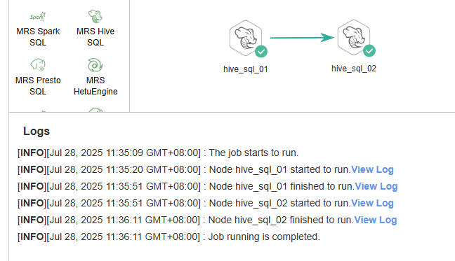

 - Click Test above the canvas. In the displayed dialog box, the job variables are displayed. Click OK to test the job.
If the test fails, view the logs of the job node and locate and rectify the fault.
Figure 6 Testing a DataArts Studio job
     In this example, the logs show that data has been successfully inserted into the test_table table.
... 1,Zhangsan,30,Male

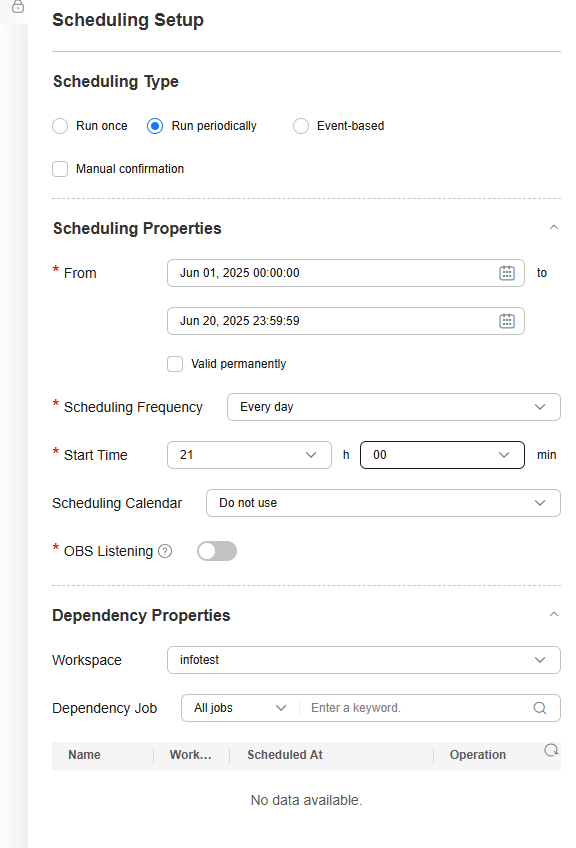

 - After the job is successfully executed, click the blank area in the canvas. On the Scheduling Setup page on the right sidebar, configure the scheduling policy of the job.
DataArts Studio jobs support multiple scheduling modes. For example, you can enable the current job to automatically run at a fixed time every day within a specified period.
Figure 7 Configuring DataArts Studio job scheduling
     For more information about DataArts Studio job scheduling modes and restrictions, see DataArts Studio Scheduling Jobs.

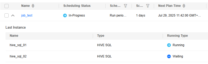

Click Execute. On the DataArts Factory page, choose Monitoring > Job Monitoring to check the scheduling status and historical execution results of the job.
Figure 8 Viewing the job status
