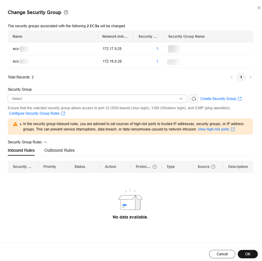

Batch Changing Security Groups of Multiple ECSs
- Log in to the ECS console and access the ECS list page.
 - In the ECS list, select the ECSs for which you want to change the security groups.
 - Choose More > Manage Security Group > Change Security Group above the ECS list.
The Change Security Group panel slides out from the right.
Figure 2 Batch changing security groups
      - Select one or more security groups to be associated with the primary NICs of the selected ECSs.
You can select multiple security groups all at one time. The security groups are sorted by the sequence in which they are selected. A smaller security group sequence number indicates a higher priority. In the select security group list, you can click Up or Down in the Operation column to adjust the priority of the security groups.
To create a security group, click Create Security Group.
      Using multiple security groups may deteriorate ECS network performance. You are advised to select no more than five security groups.
 - Click OK.
