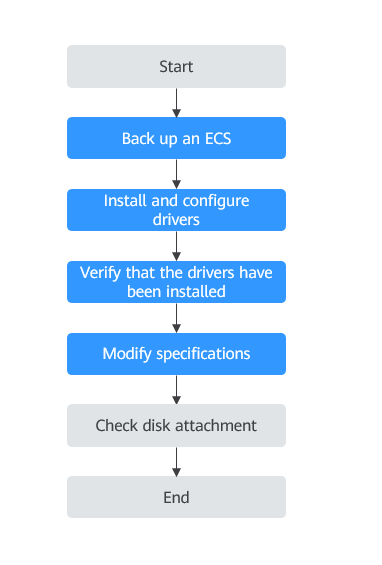

Procedure
Step |
Description |
1 |
2 |
3 |
4 |
5 |
