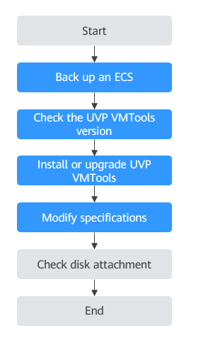

Table 1 describes the operations for changing a Xen ECS to a KVM ECS.
