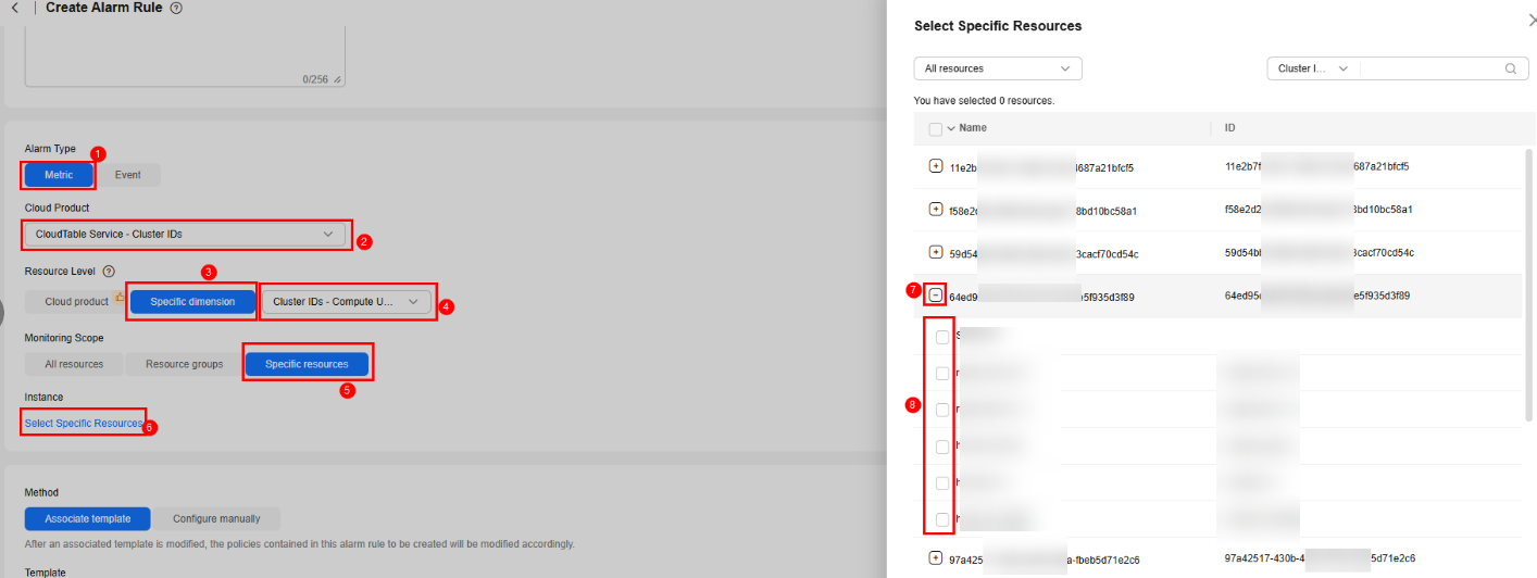

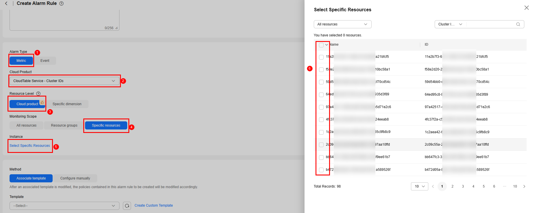

Figure 1 Configuring cluster alarm rules
Figure 2 Configuring alarm rules for cluster nodes
- After the configuration is complete, click Next.

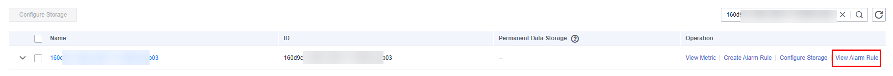

- View cluster alarm rules. Click View Alarm Rule in the Operation of the target cluster. In the displayed dialog box, you can view all alarm rules of the cluster.
Figure 3 Viewing cluster alarm rules

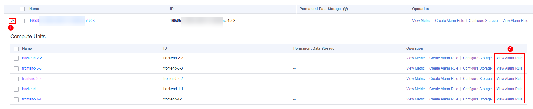

- View alarm rules for cluster nodes. Click
to expand cluster nodes. Click View Alarm Rule in the Operation of the target node. In the displayed dialog box, you can view all alarm rules of the cluster node.
Figure 4 Viewing alarm rules for cluster nodes
