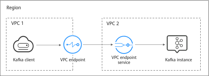

VPCs are logically isolated from each other. If a Kafka instance and a Kafka client are in different VPCs within a region, they cannot communicate with each other. In this case, you can use one of the following methods to access a Kafka instance across VPCs:
- Establish a VPC peering connection to allow two VPCs to communicate with each other. For details, see VPC Peering Connection.
- Use VPC Endpoint (VPCEP) to establish a cross-VPC connection.
The following describes how to use VPCEP to implement cross-VPC access.
VPCEP provides two types of resources: VPC endpoint services and VPC endpoints.
- A VPC endpoint service can be a Kafka instance which is accessed using VPC endpoints.
- A VPC endpoint is a secure and private channel for connecting a VPC to a VPC endpoint service.

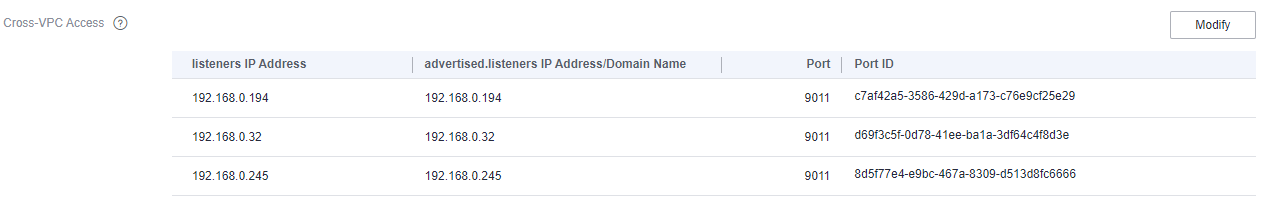

- In the Advanced Settings area on the Overview page, obtain the listeners IP addresses and port IDs of the instance for Cross-VPC Access.
Figure 2 Cross-VPC access–related listeners IP addresses and corresponding port IDs of the Kafka instance

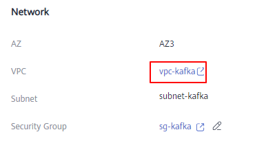

- In the Network area on the Overview page, view the VPC to which the Kafka instance belongs.
Figure 3 Viewing the VPC to which the Kafka instance belongs
- Click the VPC to obtain the VPC ID on the VPC console.

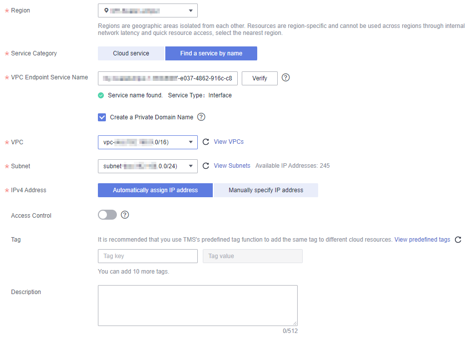

Creating a VPC Endpoint
- Click
in the upper left corner of the console. Then choose Network > VPC Endpoint. - Click Create VPC Endpoint.
- Set parameters by referring to Table 2. Retain the default values for other parameters. For details, see Creating a VPC Endpoint.
Figure 5 VPC endpoint parameters
Table 2 VPC endpoint creation parameters Parameter
Description
Region
Region where the endpoint is located. Select the region that the Kafka instance is in.
Service Category
- Cloud services: Select this option if the VPC endpoint service to be accessed is a cloud service.
- Find a service by name: Select this option if the VPC endpoint service to be accessed is a private service of your own.
Select Find a service by name.
VPC Endpoint Service Name
Enter the VPC endpoint service name recorded in 8 and click Verify. If Service name found is displayed, proceed with subsequent operations.
(Optional) Create a Private Domain Name
If you want to access a VPC endpoint using a domain name, select Create a Private Domain Name.
VPC
VPC where the endpoint is located. Select the VPC that the Kafka client is in.
Subnet
Subnet where the endpoint is located. Select the subnet that the Kafka client is in.
IPv4 Address
IPv4 address of the endpoint. Select Automatically assign IP address.
- Click Create Now.
- Confirm the configurations and submit the request.
- Go back to the VPC endpoint list and check whether the status of the created VPC endpoint has changed to Accepted. The Accepted state means that the VPC endpoint has been connected to the VPC endpoint service.
Figure 6 Checking the VPC endpoint status
- Click the VPC endpoint ID. On the Summary tab page, obtain the private IP address. You can use the private IP address to access the VPC endpoint service.
To access a VPC endpoint using a domain name, view and record the private domain name on the Basic Information page.
To copy a private domain name, do not carry the last period (.). Correct domain name format: vpcep-5xxx7-e302-4ab4-bc6c-54xxxe52.xx-xx-xx.xxx.com.
- Repeat 1 to 7 to create a VPC endpoint for each VPC endpoint service created in 9, and view and record the private IP addresses of the VPC endpoint services.
To access a VPC endpoint using a domain name, record the private domain name.

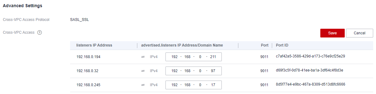

Modifying Parameter advertised.listeners IP
- Click
in the upper left corner and choose Application > Distributed Message Service for Kafka to open the Kafka instance list. - Click the desired Kafka instance to view its details.
- In the Advanced Settings area on the Overview page, click Modify for Cross-VPC Access to change the value of advertised.listeners IP address/domain name to the private IP addresses recorded in 7 and 8. Each IP address must match the corresponding port ID. Otherwise, the network will be disconnected. After the modification, click Save.
To access an endpoint using a domain name, in the Advanced Settings area on the Overview page, click Modify. In the advertised.listeners IP Address/Domain Name column, click
to switch to the domain name mode. Change it to the private domain name recorded in 7 and 8. Each private domain name must match the corresponding port ID. Otherwise, the network will be disconnected.

- The address for connecting to a Kafka instance is in the format of "advertised.listeners IP:9011". For example, the addresses for connecting to the Kafka instance shown in Figure 7 are 192.168.0.211:9011,192.168.0.97:9011,192.168.0.17:9011.
To access an endpoint using a domain name, the address of the Kafka instance is domain name:9011. For example, vpcep-5xxx7-e302-4ab4-bc6c-54xxxe52.xx-xx-xx.xxx.com:9011.
