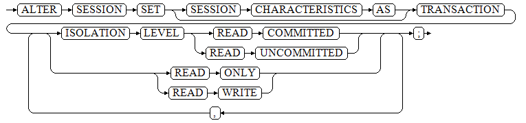

- Set transaction parameters of a session.
1 2
ALTER SESSION SET [ SESSION CHARACTERISTICS AS ] TRANSACTION { ISOLATION LEVEL { READ COMMITTED | READ UNCOMMITTED } } | { READ ONLY | READ WRITE } } [, ...] ;

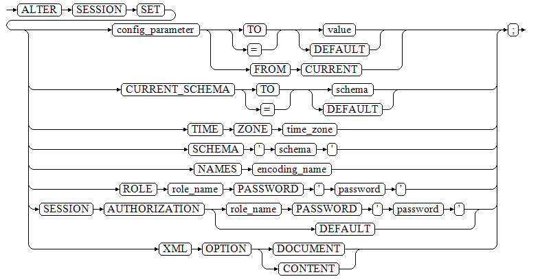

1 2 3 4 5 6 7 8 9 10
ALTER SESSION SET {{config_parameter { { TO | = } { value | DEFAULT } | FROM CURRENT }} | CURRENT_SCHEMA { TO | = } { schema | DEFAULT } | TIME ZONE time_zone | SCHEMA 'schema' | NAMES encoding_name | ROLE role_name PASSWORD 'password' | SESSION AUTHORIZATION { role_name PASSWORD 'password' | DEFAULT } | XML OPTION { DOCUMENT | CONTENT } } ;

- config_parameter
Specifies the name of a configurable GUC parameter. You can use SHOW ALL to view available GUC parameters.
- value
Specifies the new value of config_parameter. This parameter can be specified as string constants, identifiers, numbers, or comma-separated lists of these. DEFAULT is used to set default values for parameters.
- DEFAULT
 - OFF
 - RESET
 - User-specified value: The value must meet the restriction of the modified parameter.
 - FROM CURRENT
Uses the value of configuration_parameter of the current session.
 - value
- CURRENT_SCHEMA
schema
Specifies the current schema.
Value range: an existing schema name. If the schema name does not exist, the value of CURRENT_SCHEMA will be empty.
- TIME ZONE timezone
Specifies the local time zone for the current session.
Value range: a valid local time zone. The corresponding GUC parameter is TimeZone. The default value is PRC.
 - SCHEMA schema
Specifies the current schema. Here the schema is a string.
 - NAMES encoding_name
Specifies the client character encoding. This statement is equivalent to set client_encoding to encoding_name.
Value range: a valid character encoding name. The GUC parameter corresponding to this option is client_encoding. The default encoding is UTF8.
 - role_name
Value range: a string. It must comply with the naming convention.
 - password
Specifies the password of a role. It must comply with the password convention.
 - SESSION AUTHORIZATION
Sets the session user identifier of the current session.
 - XML OPTION { DOCUMENT | CONTENT }
Specifies the XML parsing mode.
Value range: CONTENT (default) and DOCUMENT
 - ISOLATION LEVEL
Specifies the transaction isolation level that determines the data that a transaction can view if other concurrent transactions exist.
Value range:
- READ COMMITTED: Only committed data can be read. This is the default value.
 - READ UNCOMMITTED: After this isolation level is set, its behavior is the same as that of READ COMMITTED.
 - Set other GUC parameters of a session.
The keyword ALTER SESSION can be omitted in the example.
1 2 3 4 5 6 7 8 9 10 11 12 13 14 15 16 17 18 19 20 21 22 23 24 25 26 27 28 29 30 31 32 33 34 35 36
-- Create the ds schema. gaussdb=#CREATE SCHEMA ds; -- Set the search path of a schema. gaussdb=#SET SEARCH_PATH TO ds, public; -- Set the time/date type to the traditional postgres format (date before month). gaussdb=#SET DATESTYLE TO postgres, dmy; -- Set the character code of the current session to UTF8. gaussdb=#ALTER SESSION SET NAMES 'UTF8'; -- Set the time zone to Berkeley of California. gaussdb=#SET TIME ZONE 'PST8PDT'; -- Set the time zone to Italy. gaussdb=#SET TIME ZONE 'Europe/Rome'; -- Set the current schema. gaussdb=#ALTER SESSION SET CURRENT_SCHEMA TO tpcds; -- Set XML OPTION to DOCUMENT. gaussdb=#ALTER SESSION SET XML OPTION DOCUMENT; -- Create the role joe, and set the session role to joe. gaussdb=#CREATE ROLE joe WITH PASSWORD '********'; gaussdb=#ALTER SESSION SET SESSION AUTHORIZATION joe PASSWORD '********'; -- Switch to the default user. gaussdb=> ALTER SESSION SET SESSION AUTHORIZATION default; -- Delete the ds schema. gaussdb=#DROP SCHEMA ds; -- Delete the role joe. gaussdb=#DROP ROLE joe;
