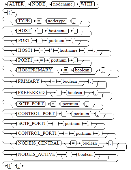

ALTER NODE nodename WITH
    [ TYPE = nodetype,]
    [ HOST = hostname,]
    [ PORT = portnum,]
    [ HOST1 = 'hostname',]
    [ PORT1 = portnum,]
    [ HOSTPRIMARY [ = boolean ],]
    [ PRIMARY [ = boolean ],]
    [ PREFERRED [ = boolean ],]
    [ SCTP_PORT = portnum,]
    [ CONTROL_PORT = portnum,]
    [ SCTP_PORT1 = portnum,]
    [ CONTROL_PORT1 = portnum, ]
    [ NODEIS_CENTRAL [ = boolean ],]
    [ NODEIS_ACTIVE [= boolean] ]
