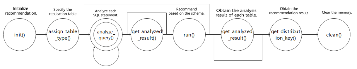

sqladvisor.init(char, boolean, boolean, boolean, int, int)
Description: Initializes parameters.
Return type: Boolean

sqladvisor.assign_table_type(text)
Description: Specifies a table as a replication table.
Parameter: table name
The specified replication table must be used before analyze_query and analyze_workload are called.
sqladvisor.analyze_query(text, int)
Description: Imports SQL statements to be recommended and analyzes the components of the statements.

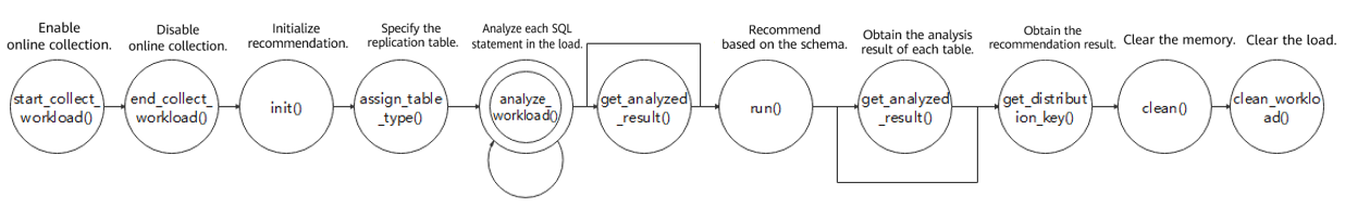

sqladvisor.analyze_workload()
Description: Analyzes the load information collected online.
sqladvisor.get_analyzed_result(text)
Description: Obtains beneficial components extracted from the current table.
Parameter: text
Return type: record

sqladvisor.run()
Description: Performs calculation and analysis based on the specified schema and input SQL statements.
sqladvisor.get_distribution_key()
Description: Obtains the recommendation result.
The analysis result is saved in a session. If the session disconnects, the result will be lost.
Return type: record

sqladvisor.clean()
Description: Clears all the memory in the recommendation process of a session.
sqladvisor.start_collect_workload(int, int)
Description: Starts online load collection.
Parameter |
Type |
Description |
Required |
sqlCount |
int |
Maximum number of SQL statements for online load collection. The value ranges from 1 to 100000 and the default value is 10000. |
Yes |
maxMemory |
int |
Maximum memory occupied by online load collection. The default value is 1024. The value ranges from 1 to 10240, in MB. |
Yes |
- The online collection function can be called only by a system administrator.
- The load of only one database can be collected at a time.
- Currently, only common SQL statements as well as DML and DQL statements in stored procedures are supported.
sqladvisor.end_collect_workload()
Description: Disables online load collection.
- The online collection function can be disabled only by a system administrator.
sqladvisor.clean_workload()
Description: Clears the memory in the load.
- The function of clearing memory in the load can be called only by a system administrator.
- You must manually execute the cleanup function.
