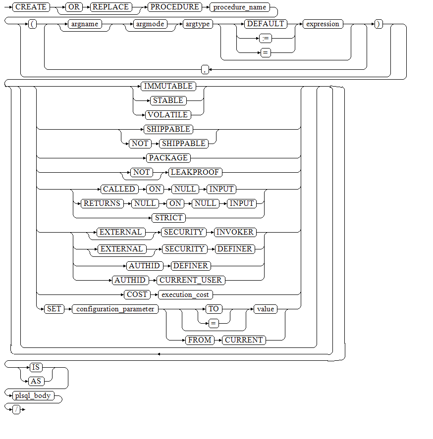

Syntax
CREATE [ OR REPLACE ] PROCEDURE procedure_name
[ ( {[ argname ] [ argmode ] argtype [ { DEFAULT | := | = } expression ]}[,...]) ]
{ IMMUTABLE | STABLE | VOLATILE }
| { SHIPPABLE | NOT SHIPPABLE }
| {PACKAGE}
| [ NOT ] LEAKPROOF
| { CALLED ON NULL INPUT | RETURNS NULL ON NULL INPUT | STRICT }
| {[ EXTERNAL ] SECURITY INVOKER | [ EXTERNAL ] SECURITY DEFINER | AUTHID DEFINER | AUTHID CURRENT_USER}
| COST execution_cost
| SET configuration_parameter { [ TO | = ] value | FROM CURRENT }
{ IS | AS }
plsql_body
