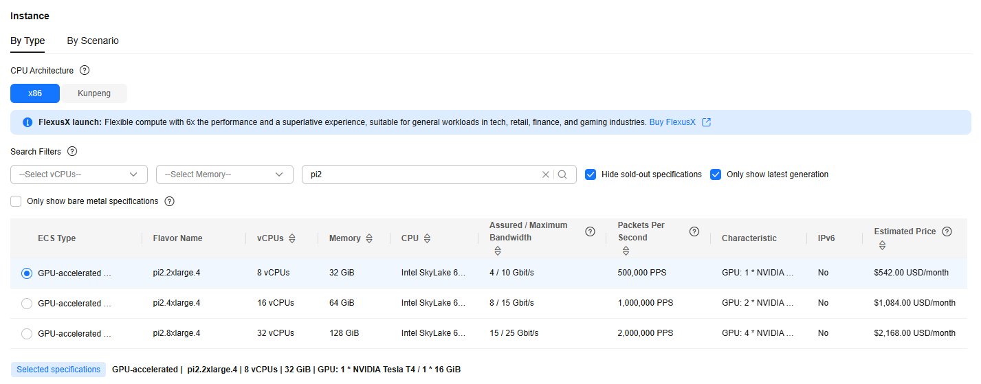

- Log in and access the Buy ECS page.
- Select a GPU-accelerated ECS (for example, Pi2 ECS that supports NVIDIA Tesla T4, A30, or L2 GPUs).
The following uses pi2.2xlarge.4 as an example.

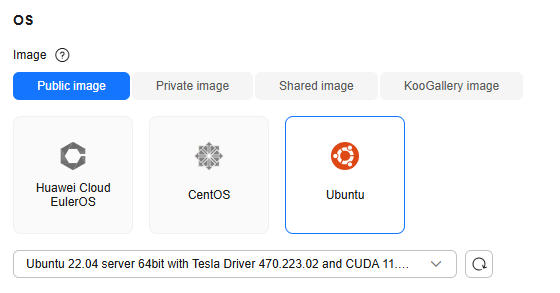

- Select an image that has the CUDA and NVIDIA driver installed.
The following uses Ubuntu 22.04 server 64bit with Tesla Driver 470.223.02 and CUDA 11.4 as an example.

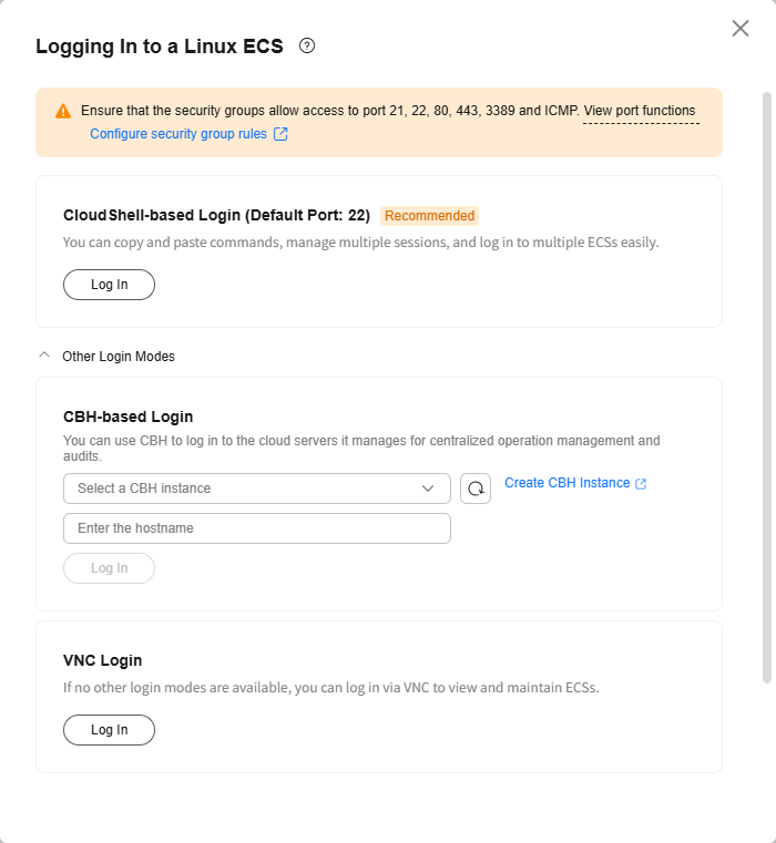

- Remotely log in to the GPU ECS (using VNC or CloudShell).
The following uses VNC login as an example.

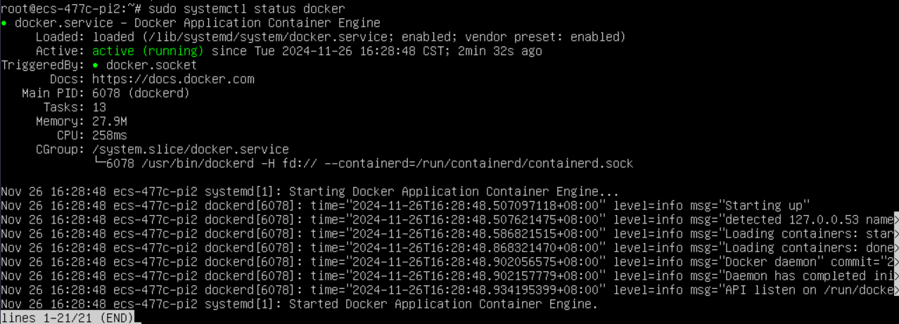

- Verify the Docker status.
sudo systemctl status docker

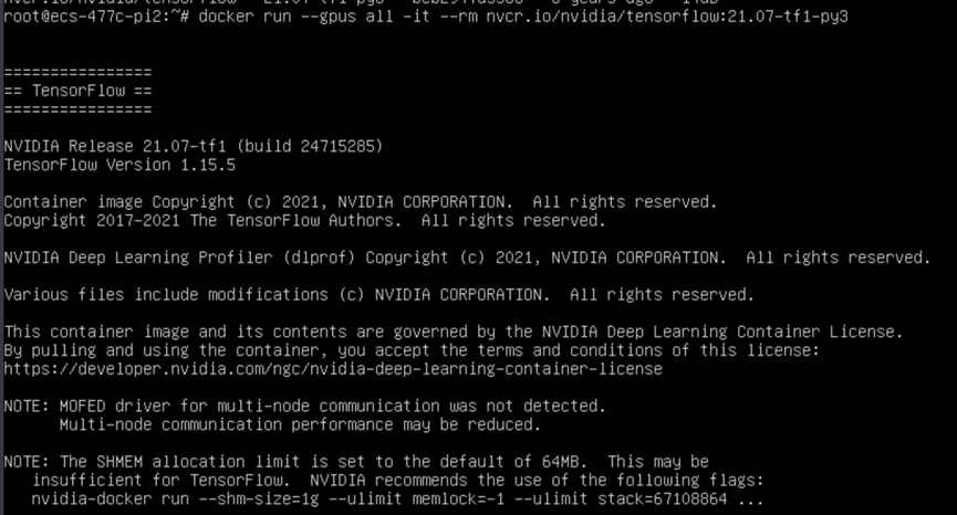

- Run the NGC container.
Run the following command to start the TensorFlow container:
docker run --gpus all -it --rm nvcr.io/nvidia/tensorflow:xx.xx-py3
For example:
docker run --gpus all -it --rm nvcr.io/nvidia/tensorflow:21.07-tf1-py3

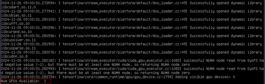

- Test TensorFlow.
Run the following commands in sequence to test TensorFlow:
python
import tensorflow as tf print("Num GPUs Available: ", len(tf.config.experimental.list_physical_devices('GPU')))In the displayed information similar to the following, check the number of GPUs.
