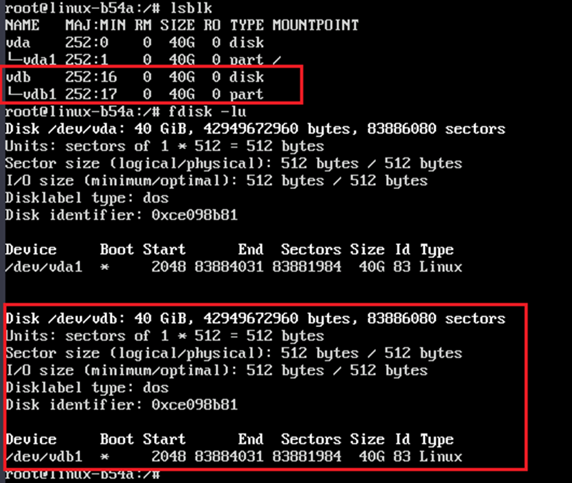

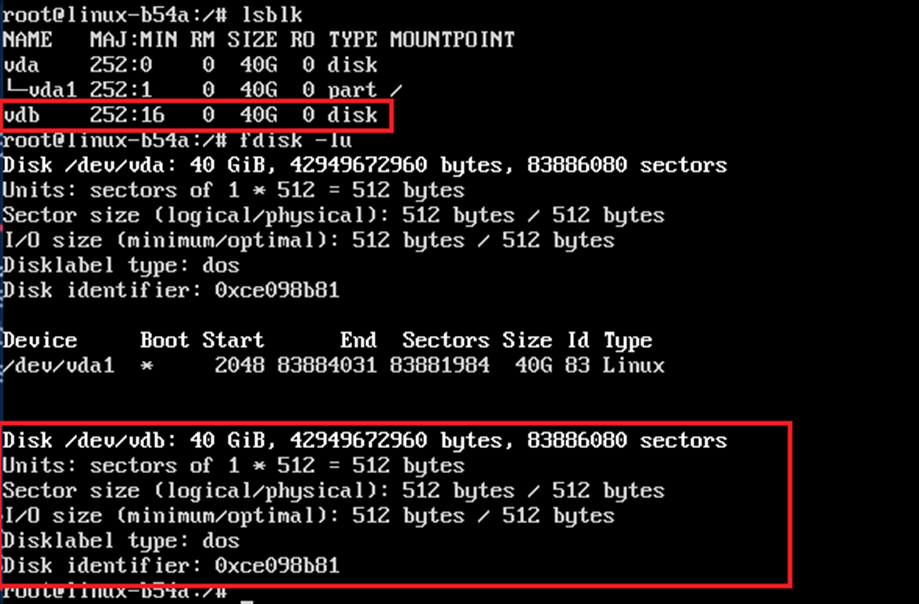

  1. Run the lsblk and fdisk -lu commands to view disk information. In the following figure, /dev/vdb is the EVS disk whose data needs to be restored. If /dev/vdb1 is displayed, the disk partition information is normal. The disk device name to be restored varies depending on the actual situation.
    • If the disk partition table is not damaged, go to 2.
    • If the disk partition table is damaged, go to 3.

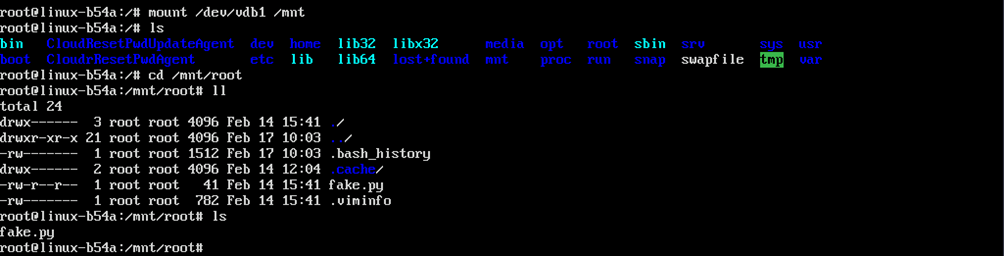

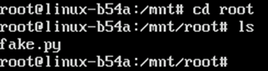

  2. Run the mount /dev/vdb1 /mnt command to attach the disk to the /mnt directory.
    Run the cd /mnt command to view the data on the system disk of the original ECS. In the corresponding path, find the data to be restored and restore it as required.
  3. Run the lsblk and fdisk -lu commands again to view the disk information. In the following figure, /dev/vdb is the disk to be restored. However, /dev/vdb1 is not displayed because the partition information is damaged or lost.

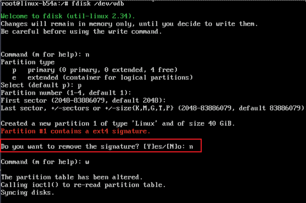

  4. Run the fdisk /dev/vdb command to partition the disk.
    If the message "Do you want to remove the signature? [Y]es/[N]o" is displayed during disk partitioning, fdisk has detected an existing partition table.
    • If you select No, the existing partition table will be retained. Then, enter w to save the partition table.
    • If you select Yes, the existing partition table will be removed and a new partition will be created. Although the data is not overwritten immediately, you may not be able to directly access the original files.

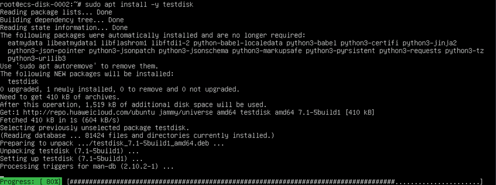

  7. Install TestDisk.
    • CentOS: sudo yum -y install testdisk
    • Ubuntu: sudo apt install -y testdisk

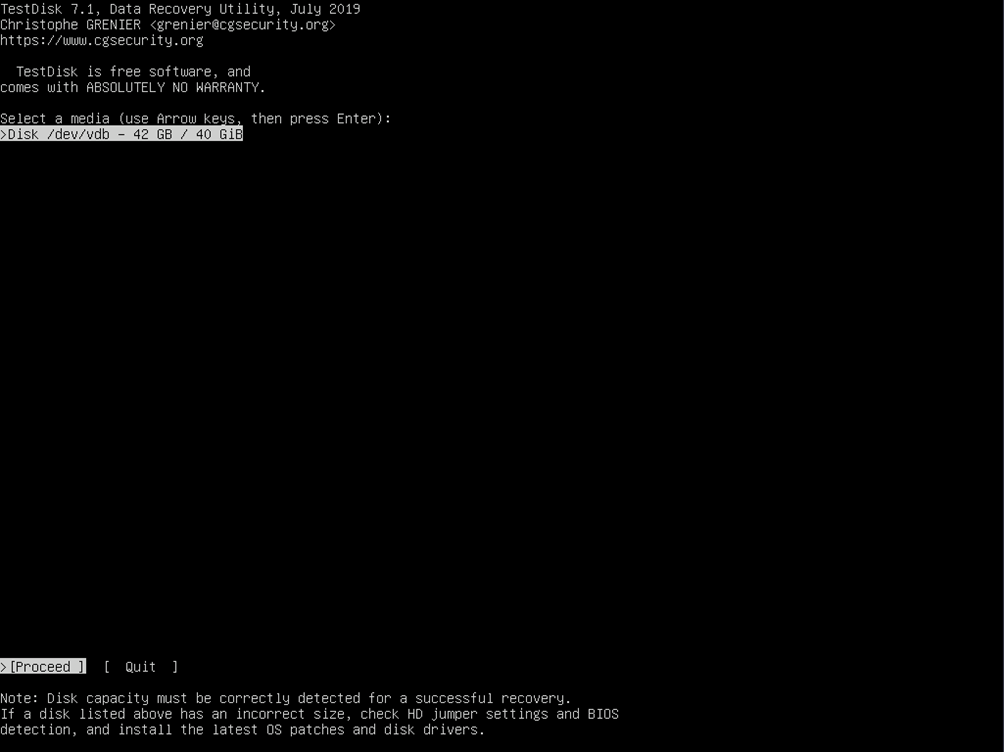

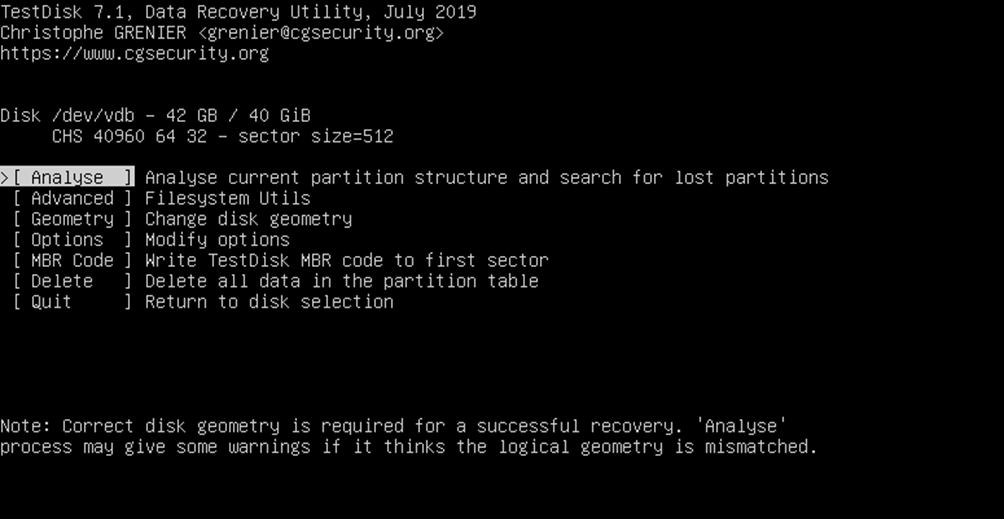

  8. Go to the TestDisk interface and run the testdisk /dev/vdb command. Replace the device name as required.
    On the TestDisk interface, use the arrow keys to select and press Enter to confirm. Other function keys are displayed in the lower part of the interface.
  9. Select [Proceed] and press Enter.

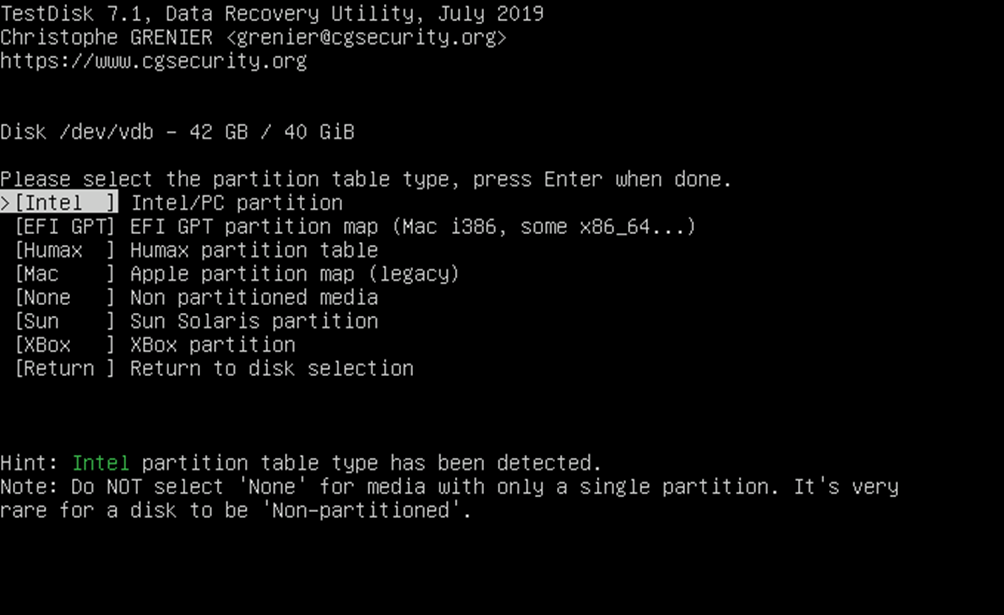

  10. Select the type of the partition tables to be scanned. Generally, select [Intel]. For GPT partitions, select [EFI GPT]. Then press Enter.

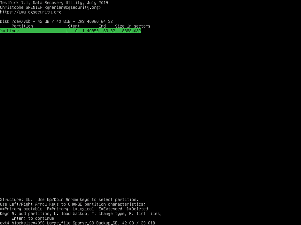

  11. Select [Analyse] and press Enter.

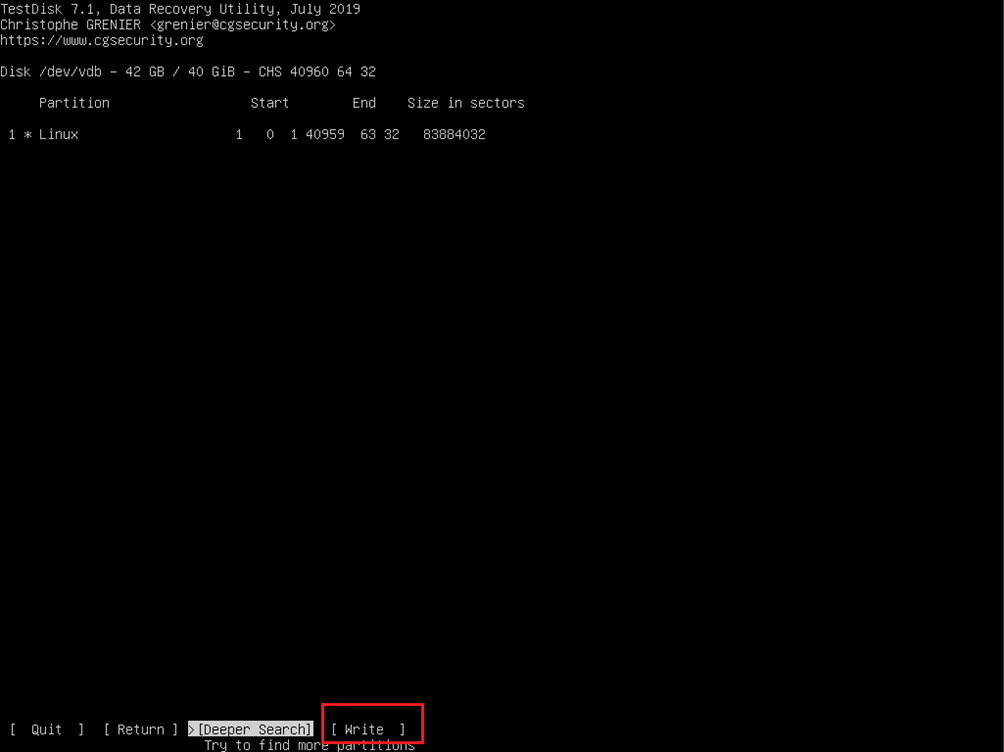

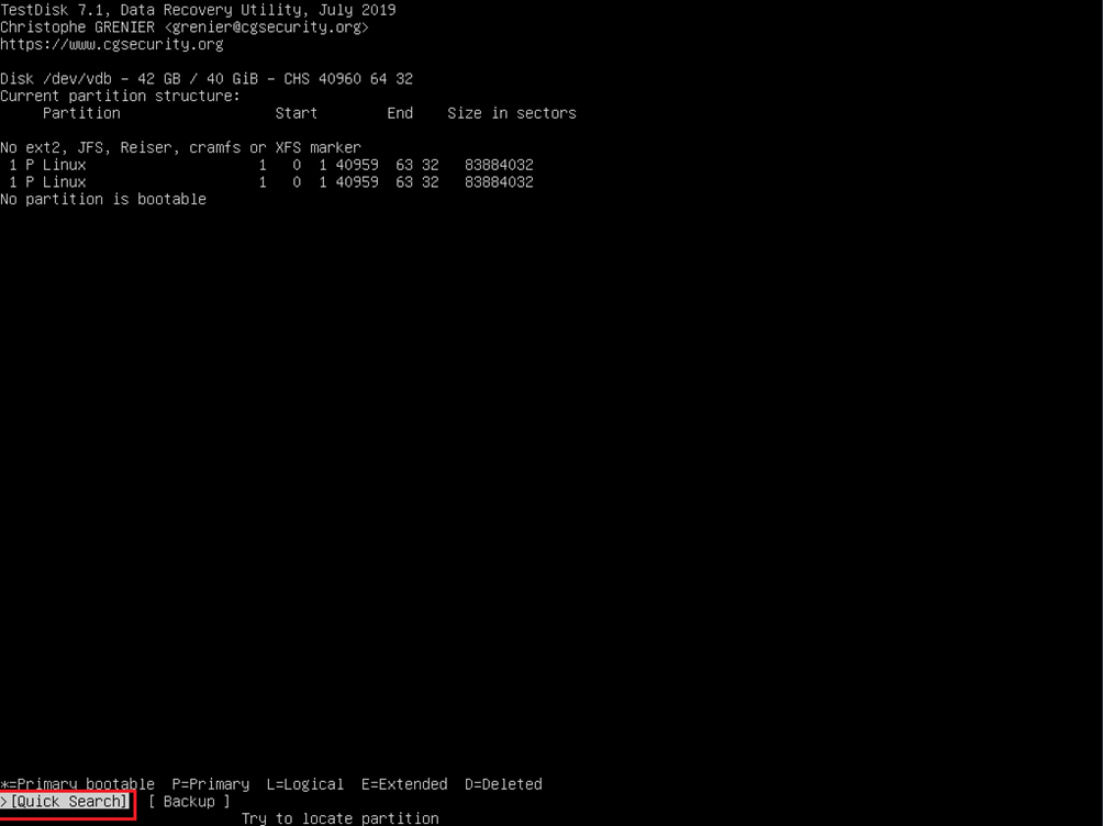

  12. If no partition information is displayed but the message "No partition is bootable" is displayed, select [Quick Search] and press Enter.
    After the search is complete, you can view the partition information, as shown in the following figure. The partition is selected by default.
    • To restore the partition, press Enter and go to 13.
    • If you only need to restore data, press P to list files and go to 14.

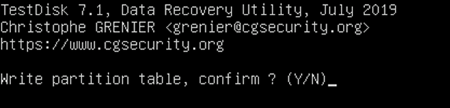

  13. Select [Write] and press Enter to save the partition.
    Press Y to save the partition as instructed.
    Retain the default option [OK] and press Enter.

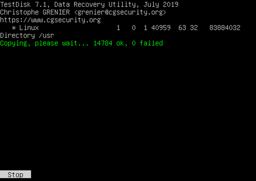

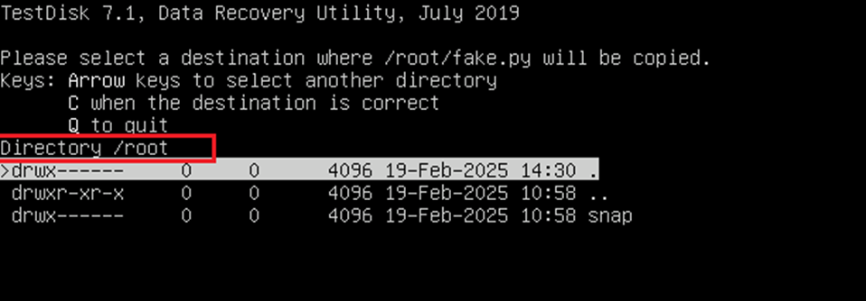

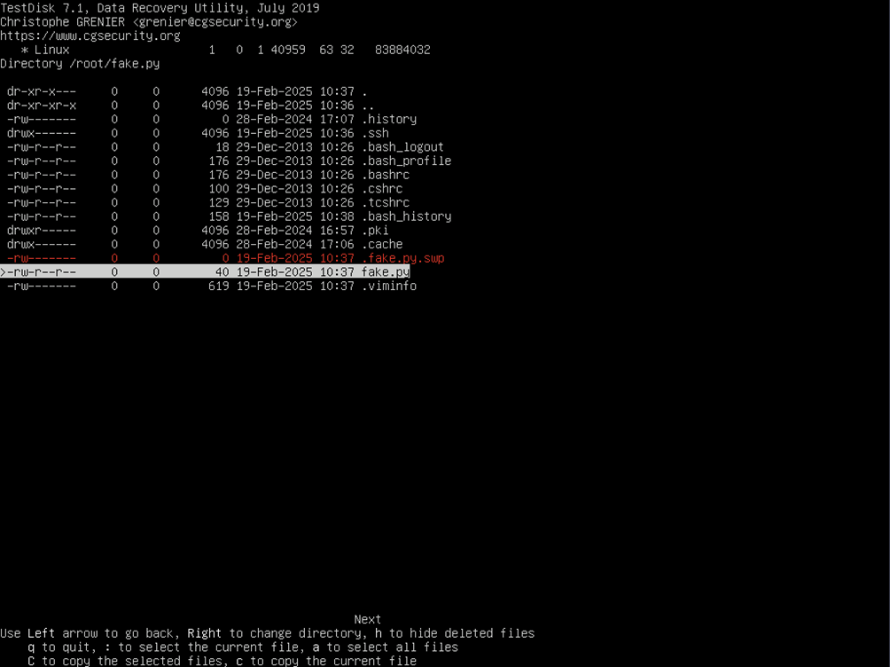

  14. Use the arrow keys to select the files or folders to be restored and press C to copy them.
    Use the arrow keys to select the target directory. The current path is displayed next to Directory. In this example, the files are restored to the /root directory. Press C in the /root directory.
    After the copy is successful, the message "Copy done!" is displayed. The number of files that were successfully copied and those that failed are displayed. If a folder is copied, wait until the copy is complete.
    Press Q multiple times until you exit the TestDisk interface. Go to the target path /root and check that the data has been restored.

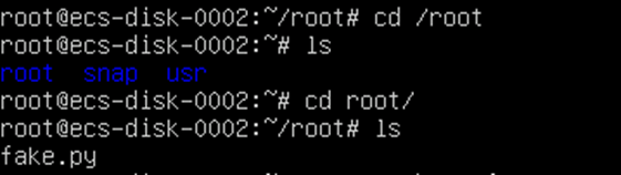

    When you paste the files or folders, the file structure is also copied to the target path. For example, if the root/fake.py file in the original disk file system is successfully copied to the /root directory, the fake.py file path will change to /root/root/fake.py.
