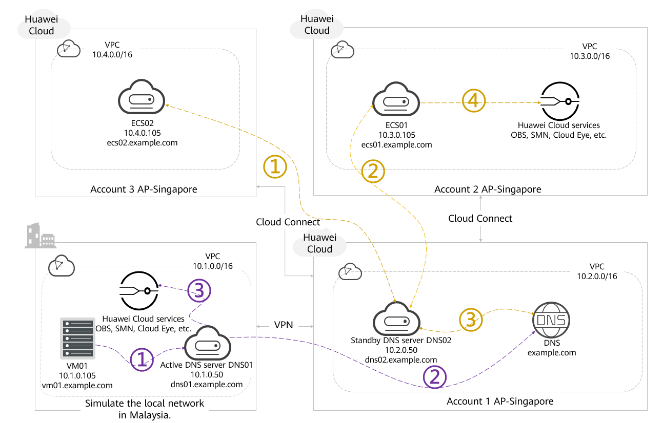

Solution
The cloud environments in Malaysia and Singapore are used to demonstrate DNS resolution using Linux BIND in a hybrid cloud.
  • A VPN connection is established between Malaysia and Singapore to allow resources to communicate across regions.
  • The sub-accounts in Singapore are interconnected through VPC peering connections. Routes are also configured to achieve the same purpose.
  • The active DNS server is set up in Malaysia using Linux BIND, while the standby DNS server is set up in an account in Singapore. The standby DNS server in Singapore is a read replica replicated from the active DNS server in Malaysia. Any update in zone files needs to be configured on the active DNS server, and is automatically synchronized to the standby DNS server by increasing the serial number in zone files.
With the preceding configurations, we can use Linux BIND for DNS resolution in a hybrid cloud. VMs in the local environment (Malaysia) will point to the active DNS server as the preferred DNS and the standby DNS server as the alternate DNS. ECSs in the cloud (Singapore) will point to the standby DNS server as the preferred DNS and the active DNS server as the alternate DNS. Both the active and standby DNS servers need to be configured to forward requests to Huawei integrated DNS. When VMs or ECSs access Huawei Cloud services (such as OBS and SMN), the endpoints of these services can be resolved. For example, if ECS01 accesses the OBS service, it sends DNS queries to DNS02. DNS02 identifies that the requested domain name is hosted by another name server and forwards the queries to Huawei integrated DNS for further resolution and response.
Figure 1 Solution diagram
  1. Users can fully utilize Linux BIND to resolve domain names in the hybrid cloud.
    In the hybrid cloud, the two DNS servers are configured as the active DNS server (DNS01) and standby DNS server (DNS02) to back up DNS records between the local and cloud environments.
    Note that both DNS servers are configured with the redundancy function. DNS02 is a read replica. All zone configuration updates can be performed only on DNS01, and DNS02 is automatically updated based on the sequence number change.
  2. Condition forwarders must be configured on both DNS servers (DNS01 and DNS02) to resolve Huawei Cloud service endpoints.
    • All ECSs on the cloud use DNS02 as the active DNS server and DNS01 as the standby DNS server.
    • All VMs in the local environment use DNS01 as the active DNS server and DNS02 as the standby DNS server.
    If ECS02 in account 3 wants to access ECS01 in account 2, it sends DNS queries to the active DNS server (DNS02). The same process applies to other ECSs on the cloud and local VMs.
  3. If VM01 in the local environment wants to access the endpoints of Huawei Cloud services (such as OBS, SMN, and Cloud Eye), it sends DNS queries to the active DNS server (DNS01). DNS01 identifies that the requested domain name is hosted on another name server and forwards DNS queries to Huawei integrated DNS for further resolution and response.
  4. If an ECS on the cloud wants to access the endpoints of Huawei Cloud services (such as OBS, SMN, and Cloud Eye), it sends DNS queries to the active DNS server (DNS02). DNS02 identifies that the requested domain name is hosted on another name server and forwards DNS queries to Huawei integrated DNS for further resolution and response.
In this practice, the IP addresses in the local network and Huawei Cloud are for reference only. In actual applications, deploy the solution based on the actual network plan.

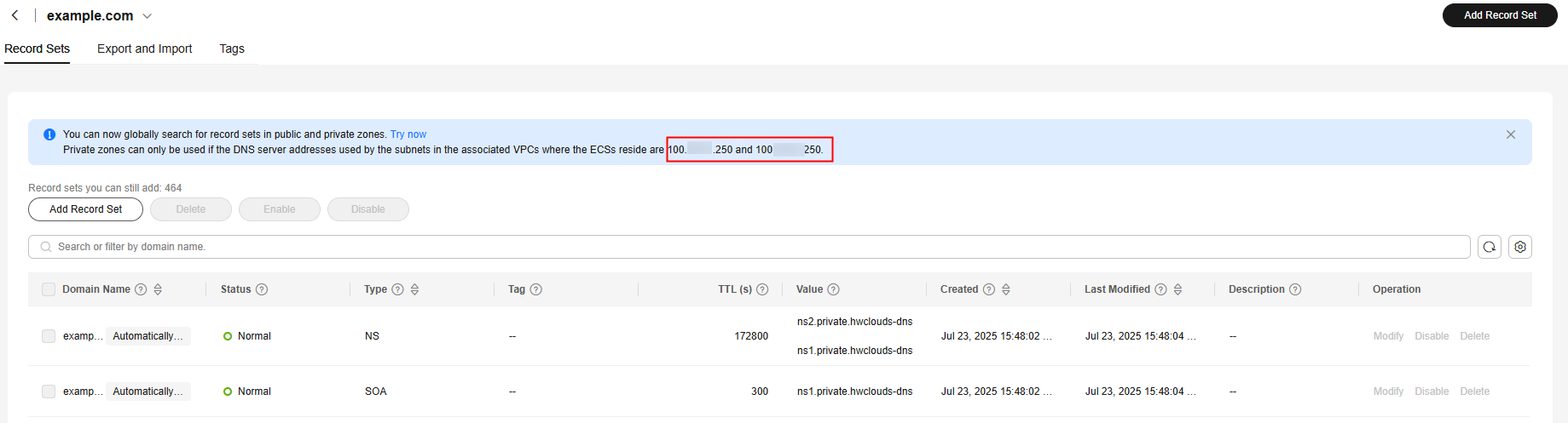

Step 1: Create a Private Zone on Huawei Cloud DNS
  1. Go to the Private Zones page.

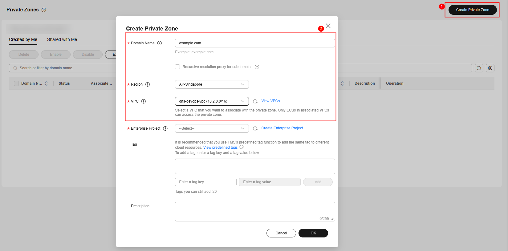

  2. In the upper right corner of the page, click Create Private Zone.
    Figure 2 Creating a private zone

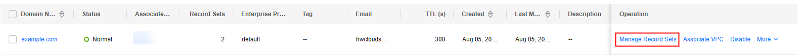

  3. Click Manage Record Sets in the Operation column. On the Record Sets tab, view and record the private DNS addresses and the values of NS and SOA record sets.
    Figure 3 Manage Record Resets
    Figure 4 Viewing and recording information

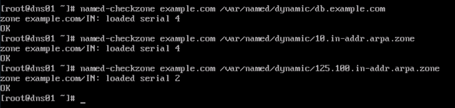

  8. Run the following command to check the syntax of the zone files:
    named-checkzone example.com /var/named/dynamic/db.example.com
    named-checkzone example.com /var/named/dynamic/10.in-addr.arpa.zone
    named-checkzone example.com /var/named/dynamic/125.100.in-addr.arpa.zone
    Figure 5 shows an output example.
    Figure 5 Output example of the named-checkzone command

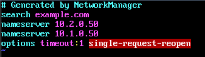

  10. Back up and update nameserver in the /etc/resolv.conf file.
    mv /etc/resolv.conf /etc/resolv.conf.orig
    vim /etc/resolv.conf
    Modify nameserver settings based on your environment requirements.
    domain example.com
    search example.com
    nameserver 10.1.0.50
    nameserver 10.2.0.50

  4. Run the following command to check the syntax of the /etc/name.conf file:
    named-checkconf
    If no content is returned, the configuration file is valid.

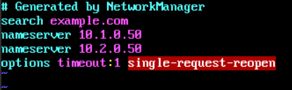

  2. Set the name servers to point to the IP addresses of the DNS servers deployed in Step 2: Configure the Active DNS Server (DNS01) and Step 3: Configure the Standby DNS Server (DNS02).
    • The nameserver configuration of VM01 is as follows.
      Figure 6 nameserver configuration example
    • The nameserver configuration of ECS01 and ECS02 is as follows.
      Figure 7 nameserver configuration example

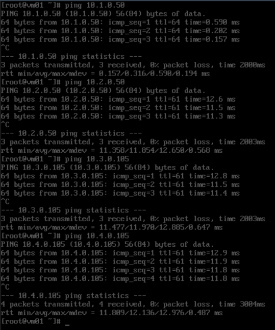

In this section, we will use the IP addresses and domain names configured in the multi-account environment to test network connectivity. The resources of multiple accounts are connected through VPN connections, VPC peering connections, and configured routes. We will also use the nslookup command to test the access to the endpoints of Huawei Cloud services (such as OBS, SMN, and Cloud Eye).
  1. Run the ping command to test the connectivity between VM01 and ECS01 and between VM01 and ECS02.
    1. Ping the IP addresses of ECS01 and ECS02 from VM01.
      Figure 8 Pinging the IP addresses of ECS01 and ECS02 from VM01

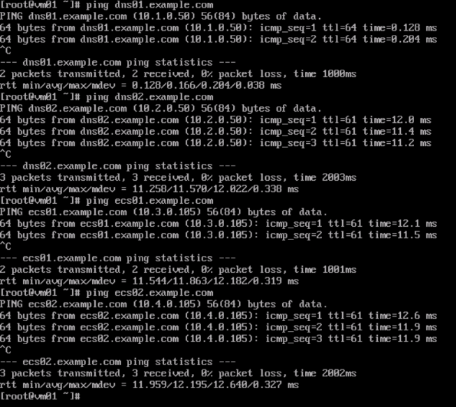

    2. Ping the domain names of ECS01 and ECS02 from VM01.
      Figure 9 Pinging the domain names of ECS01 and ECS02 from VM01

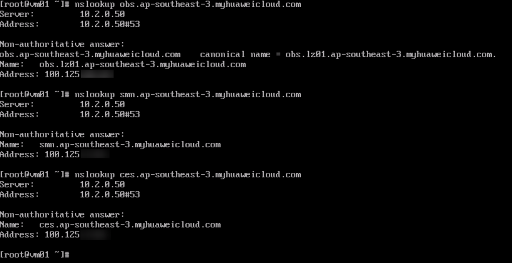

    3. Test the connectivity between VM01 and Huawei Cloud services.
      Figure 10 Accessing the endpoints of Huawei Cloud services from VM01

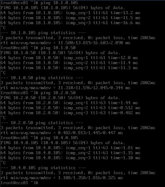

  2. Run the ping command to test the connectivity between ECS01 and VM01 and between ECS01 and ECS02.
    1. Ping the IP addresses of VM01 and ECS02 from ECS01.
      Figure 11 Pinging the IP addresses of VM01 and ECS02 from ECS01

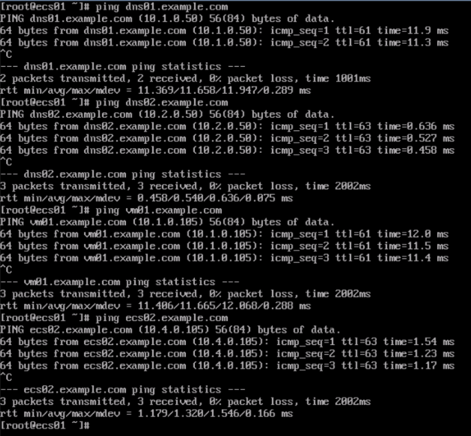

    2. Ping the domain names of VM01 and ECS02 from ECS01.
      Figure 12 Pinging the domain names of VM01 and ECS02 from ECS01

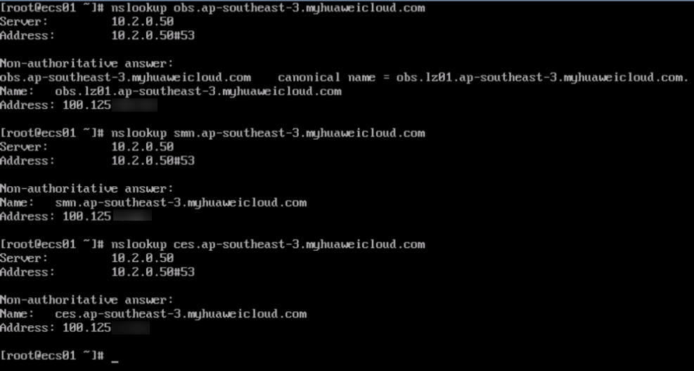

    3. Test the connectivity between ECS01 and Huawei Cloud services.
      Figure 13 Accessing the endpoints of Huawei Cloud services from ECS01

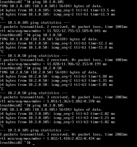

  3. Run the ping command to test the connectivity between ECS02 and VM01 and between ECS02 and ECS01.
      Figure 14 Pinging the IP addresses of VM01 and ECS02 from ECS01

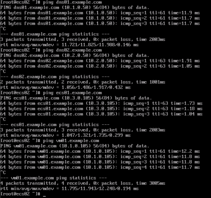

    2. Ping the domain names of VM01 and ECS01 from ECS02.
      Figure 15 Pinging the domain names of VM01 and ECS01 from ECS02

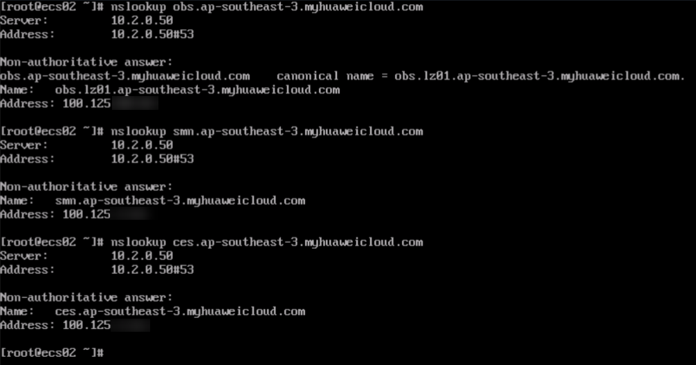

    3. Test the connectivity between ECS02 and Huawei Cloud services.
      Figure 16 Accessing the endpoints of Huawei Cloud services from ECS02
