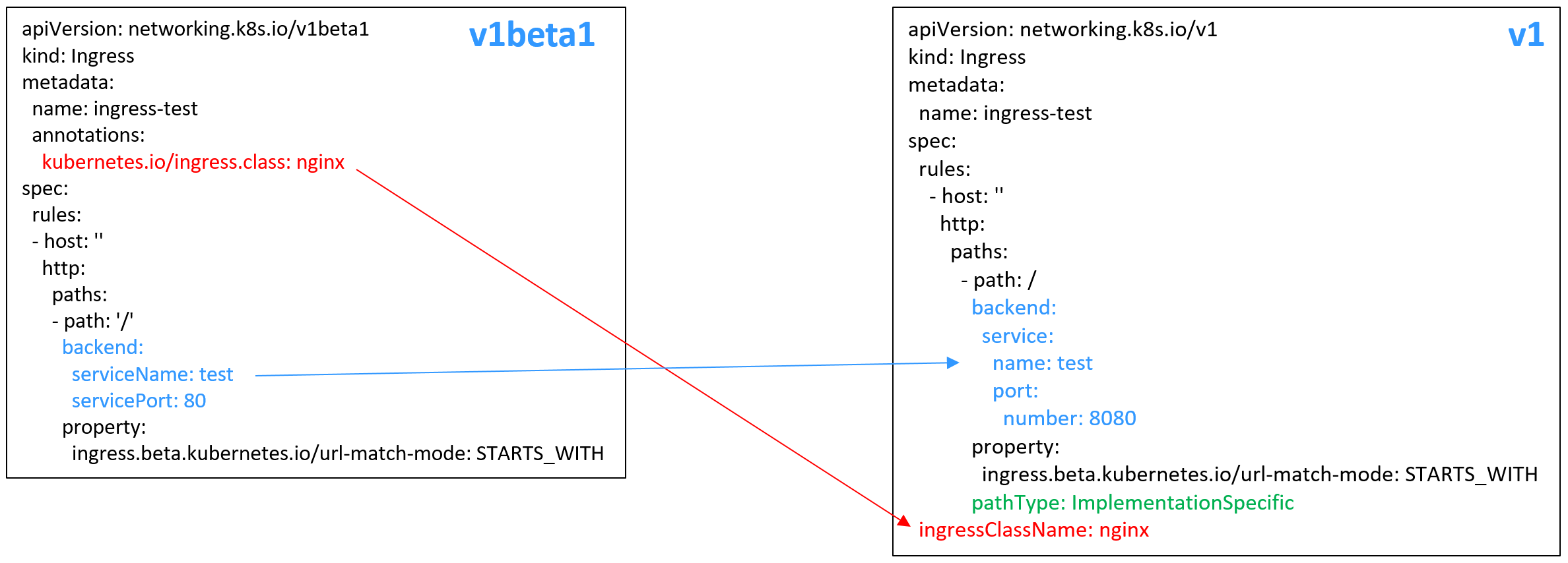

Ingress Description of networking.k8s.io/v1
In CCE clusters of v1.23 or later, the ingress version is switched to networking.k8s.io/v1.
Compared with v1beta1, v1 has the following differences in parameters:
  • The ingress type is changed from kubernetes.io/ingress.class in annotations to spec.ingressClassName.
  • The format of backend is changed.
  • The pathType parameter must be specified for each path. The options are as follows:
    • ImplementationSpecific: The matching method depends on Ingress Controller. The matching method defined by ingress.beta.kubernetes.io/url-match-mode is used in CCE, which is the same as v1beta1.
    • Exact: exact matching of the URL, which is case-sensitive.
    • Prefix: matching based on the URL prefix separated by a slash (/). The match is case-sensitive, and elements in the path are matched one by one. A path element refers to a list of labels in the path separated by a slash (/).

    Starting from cluster v1.23, the ingress version is switched from networking.k8s.io/v1beta1 to networking.k8s.io/v1. For details about the differences between v1 and v1beta1, see Ingress Description of networking.k8s.io/v1.
    The following uses HTTP as an example to describe how to configure the YAML file:
    For clusters of v1.23 or later:
    apiVersion: networking.k8s.io/v1
    kind: Ingress
    metadata:
    spec:
      rules:
        - host: ''
          http:
            paths:
              - path: /
                backend:
                  service:
                    name: <your_service_name>  # Replace it with the name of your target Service.
                    port:
                      number: <your_service_port>  # Replace it with the port number of your target Service.
                property:
                  ingress.beta.kubernetes.io/url-match-mode: STARTS_WITH
                pathType: ImplementationSpecific
      ingressClassName: nginx   # Nginx Ingress is used.
    For clusters of v1.21 or earlier:
    apiVersion: networking.k8s.io/v1beta1
    kind: Ingress
    metadata:
      namespace: default
      annotations:
        kubernetes.io/ingress.class: nginx   # Nginx Ingress is used.
    spec:
      rules:
        - host: ''
          http:
            paths:
              - path: '/'
                backend:
                  serviceName: <your_service_name>  # Replace it with the name of your target Service.
                  servicePort: <your_service_port>  # Replace it with the port number of your target Service.
