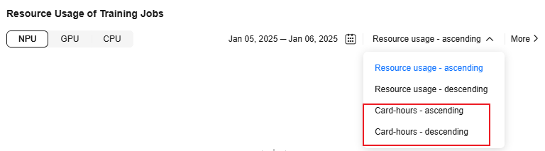

Table 1 shows the metrics that can be viewed on the training job details page of the ModelArts console.
Table 1 shows the training metrics that can be viewed on the Overview page of the ModelArts console.
| Metric | Description | How to View |
| Training job resource usage | CPU, GPU, or NPU usage of a training job. | ModelArts console > Overview > Resource Usage of Training Jobs |
| Card-hours | Running duration and number of cards used by a training job. | ModelArts console > Overview > Resource Usage of Training Jobs
