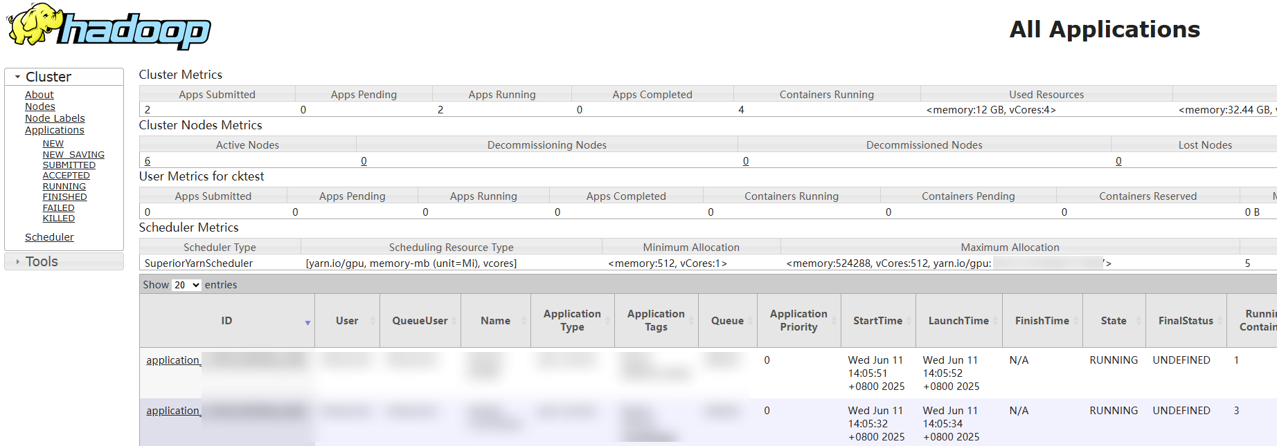

Viewing Job Logs on the YARN Web UI
- Log in to FusionInsight Manager of the MRS cluster.
For details about how to log in to FusionInsight Manager, see Accessing MRS Manager.
- Choose Cluster > Services > Yarn and click the hyperlink on the right of ResourceManager Web UI.
- On the displayed All Applications page, click Logout in the upper right corner. Then, log in again as a YARN administrator or a user who submits jobs.
To create a YARN administrator, perform the following steps:
- Create a role with the YARN administrator permissions. For details, see Creating YARN Roles.
- Create a human-machine user and associate the role created in 3.a with the user. For details, see Creating an MRS Cluster User.
After a user is created, you need to change the initial password as prompted after logging in to FusionInsight Manager as the user.
- On the All Applications page, click the application ID of a job to view the job running information, and click Logs to view the logs.
Figure 1 Viewing YARN job logs
- View the logs of a specified YARN job on the client.
- Log in to the node where the cluster client is located as user root.
- Run the following command to initialize environment variables:
source Client installation directory/bigdata_env
- If Kerberos authentication is enabled for the current cluster, run the following command to authenticate the current user (YARN administrator or a user who submits jobs). If Kerberos authentication is disabled for the current cluster, skip this step.
kinit MRS cluster user
- Run the following command to obtain the logs of a specified job:
yarn logs -applicationId Application ID of the required job
