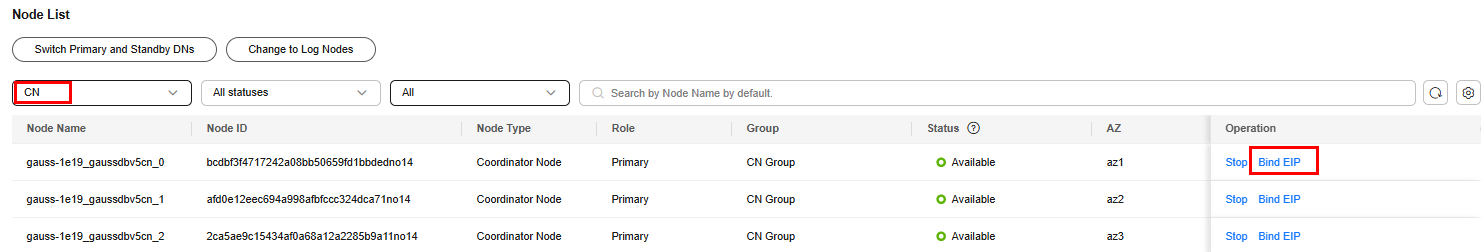

 - Click
 in the upper left corner and select a region and project. - Click
 in the upper left corner of the page and choose . - On the Instances page, click the name of the target instance to go to the Basic Information page.
 - In the Node List area, click Bind EIP in the Operation column.

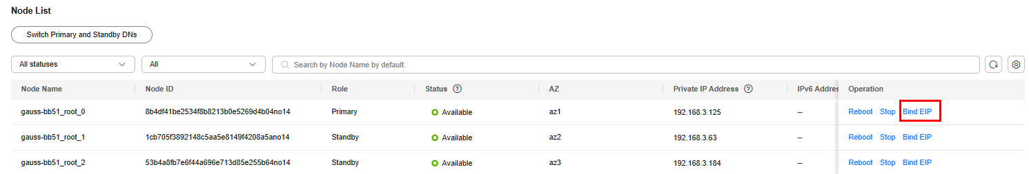

      For a distributed instance, switch to CN in the filter area first and then bind an EIP.Figure 1 Binding an EIP (distributed instance)
       Figure 2 Binding an EIP (centralized instance)

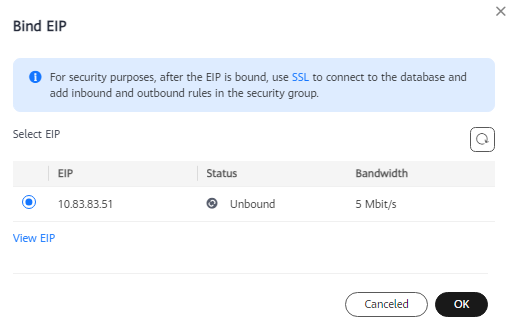

       - In the displayed dialog box, all available unbound EIPs are listed. Select the required EIP and click OK.
If no available EIPs are displayed, click View EIP and obtain an EIP.
Figure 3 Binding an EIP
       - In the Node List area, check the operation result in the EIP column.
      Figure 4 Checking the binding result

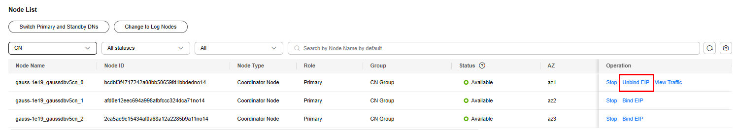

 - Click
 in the upper left corner of the page and choose . - On the Instances page, click the instance that has been bound with an EIP.

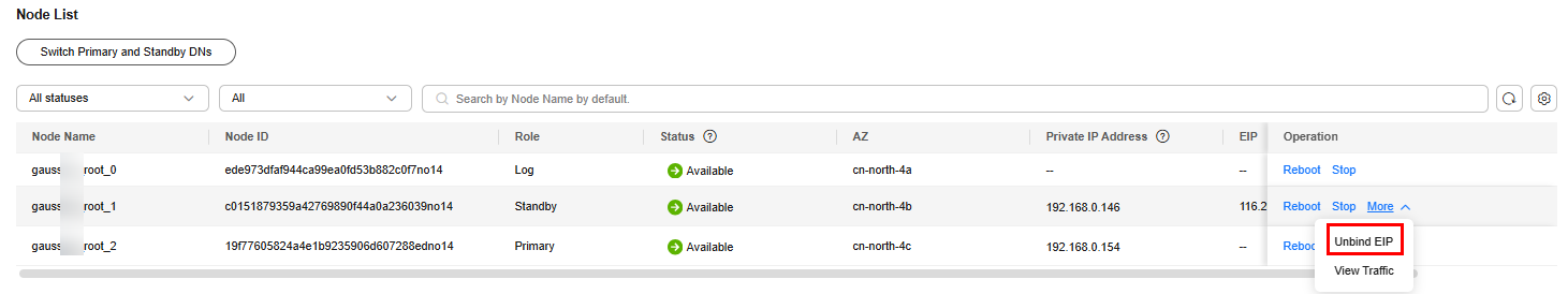

 - In the Node List area, click Unbind EIP in the Operation column.
- For a distributed instance, switch to CN in the filter area first and then click Unbind EIP in the Operation column.
 - For a centralized instance, click More and choose Unbind EIP in the Operation column.
Figure 5 Unbinding an EIP (distributed instance)
      Figure 6 Unbinding an EIP (centralized instance)
       - In the displayed dialog box, click OK to unbind the EIP.
