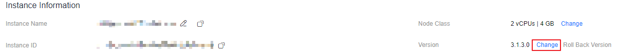

  3. On the Basic Information page, in the Instance Information area, click Change beside the Version field.
    Figure 1 Upgrading the version of a DDM instance

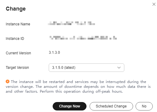

  4. In the displayed dialog box, select Target Version. The system will perform an upgrade or a downgrade based on the target version you selected.
    Figure 2 Selecting the target version

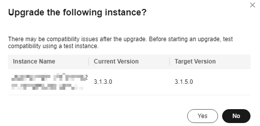

  5. Click Change Now. In the displayed dialog box, click Yes.
    Figure 3 Confirming the change

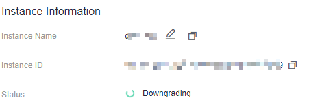

  6. When the version is being changed, the instance status becomes Upgrading or Downgrading. After the change is complete, the instance status changes to Running, and the instance version becomes the target version.
    Figure 4 Downgrading
