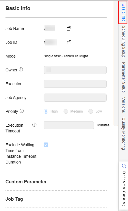

Configuring Basic Job Information
After you configure the owner and priority for a job, you can search for the job by the owner and priority. The procedure is as follows:
Click the Basic Info tab on the right of the canvas to expand the configuration page and configure the job parameters listed in Table 2.
Figure 3 Configuring basic job information
Table 2 Basic job information
Parameter
Description
Owner
An owner configured during job creation is automatically matched. This parameter value can be modified.
Executor
This parameter is available when Scheduling Identities is set to Yes.
User that executes the job. When you enter an executor, the job is executed by the executor. If the executor is left unspecified, the job is executed by the user who submitted the job for startup.
NOTE:
You can configure execution users only after you apply for the whitelist membership. To enable it, contact customer service or technical support.
Job Agency
After an agency is configured, the job interacts with other services as an agency during job execution.
Priority
Priority configured during job creation is automatically matched. This parameter value can be modified.
Execution Timeout
Timeout of the job instance. If this parameter is set to 0 or is not set, this parameter does not take effect. If the notification function is enabled for the job and the execution time of the job instance exceeds the preset value, the system sends a specified notification.
Exclude Waiting Time from Instance Timeout Duration
Whether to exclude the wait time from the instance execution timeout duration
  • If you select this option, the time to wait before an instance starts running is excluded from the timeout duration. You can modify this setting on the Default Configuration page.
  • If you do not select this option, the time to wait before an instance starts running is included in the timeout duration.
Custom Parameter
Set the name and value of the parameter.
Job Tag
Configure job tags to manage jobs by category.
Click Add to add a tag to the job. You can also select a tag configured in Managing Job Tags.
Node Status Polling Interval (s)
How often the system checks completeness of the node task. The value ranges from 1 to 60 seconds.
Max. Node Execution Duration
Execution timeout interval for the node. If retry is configured and the execution is not complete within the timeout interval, the node will be executed again.
Retry upon Failure
You can select Retry 3 times or Never. Never is recommended.
You are advised to configure automatic retry only for file migration jobs or database migration jobs with Import to Staging Table enabled to avoid repeated data writes caused by automatic retry.
NOTE:
If you want to set parameters in DataArts Studio DataArts Factory to schedule the CDM migration job, do not configure this parameter. Instead, set parameter Retry upon Failure for the CDM node in DataArts Factory.
Policy for Handling Subsequent Nodes If the Current node Fails
Policy for handling subsequent nodes if the current node fails
  • End the current job execution plan: Execution of the current job will stop, and the job instance status will become Failed. If the job is scheduled periodically, subsequent periodic scheduling will run properly.
  • Ignore the failure and set the job execution result to success: The failure of the current node will be ignored. The job instance status will become Failure ignored. If the job is scheduled periodically, subsequent periodic scheduling will run properly.
