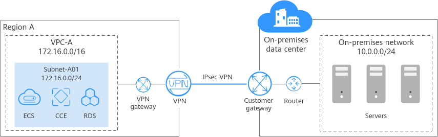

VPN provides an encrypted, Internet-based channel that connects an on-premises data center and the cloud.
For details, see Configuring Enterprise Edition S2C VPN to Connect an On-premises Data Center to a VPC.
In Figure 1, some workloads have been migrated to a VPC (VPC-A), and some workloads are still running on on-premises servers. With a VPN connection, on-premises servers can quickly access the cloud resources in the VPC. Compared with Direct Connect, VPN is easier to configure and cost-effective.

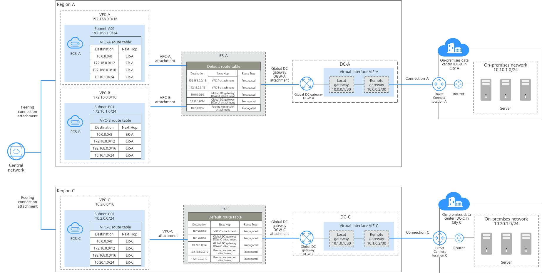

You can attach VPCs and Direct Connect global DC gateways in the same region to an enterprise router, and then add the enterprise routers in different regions to a central network. In this way, VPCs in different regions can communicate with on-premises data centers in multiple cities. Compared with a cloud connection, using a central network features a simpler architecture and higher scalability.
In Figure 6, VPCs and global DC gateways in each region are attached to different enterprise routers, so the on-premises data center in each city can access the VPCs in the corresponding region. Then the two enterprise routers (ER-A and ER-C) are connected over a central network. In this way, the three VPCs (VPC-A, VPC-B, and VPC-C) and two on-premises data centers (IDC-A and IDC-C) are on the same cloud network and can communicate with each other. In this solution, only the enterprise router in each region is added to the central network, simplifying the network architecture. Also, with global DC gateways attached to enterprise routers, VPCs can share Direct Connect connections to communicate with the on-premises data centers. Route learning of enterprise routers eliminates complex configurations and simplifies maintenance.
