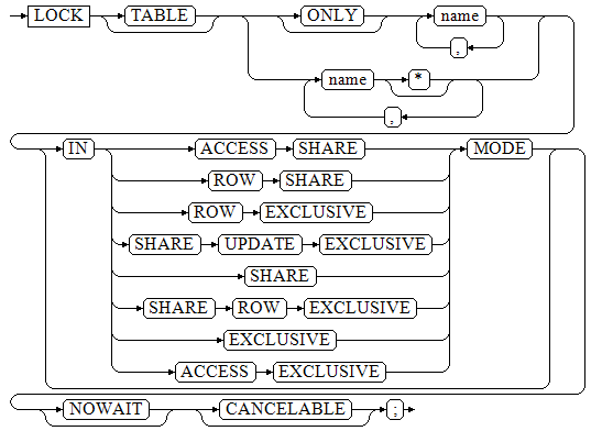

Syntax
LOCK [ TABLE ] {[ ONLY ] name [, ...]| {name [ * ]} [, ...]}
    [ IN {ACCESS SHARE | ROW SHARE | ROW EXCLUSIVE | SHARE UPDATE EXCLUSIVE | SHARE | SHARE ROW EXCLUSIVE | EXCLUSIVE | ACCESS EXCLUSIVE} MODE ]
    [ NOWAIT ][CANCELABLE];
